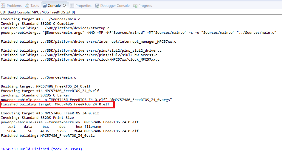

I'm using nxp s32 for power architecture 2017_R1. I tried  to create  a project out of single in toggle mpc5777c elf example and build it.
When i built it says the elf. File has been created in the console and but in the project explorer window the binaries is not getting displayed
Under my project name above includes

Yes I had to change refresh policy then it worked thanks

Hi Vignesh,
If the elf file has been created = successfully built (you can check it in the build console)
then this is perhaps IDE refresh issue. Please try to refresh IDE by hitting F5 or go menu "File->Refresh"
and you should be able to see the elf file under binaries:
hope it helps.
