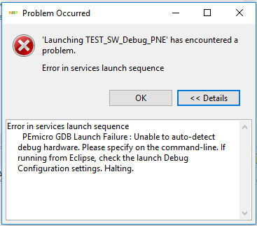

spn0534
hello
i have use s32 design studio for ARM(2018 version)
i have face problem at time of debugging like
How can I solve this problem?

jiri_kral
what's your target MCU and debug probe?
Jiri

jiri_kral
did you properly installed PE Micro's Cyclone driver? Isn't your debug probe in use by other application?

jiri_kral
sorry for delay. Did you try use PE Micro tools as suggested in your previous thread? - https://community.nxp.com/message/1253788
Just make sure, that Cyclone is working under your OS.

spn0534
hi jiri,
1)i don't have any PE Micro tools
is it any software tool?
2)I have change the PEMicro interface as openSDA embedded Debug -USB port then also i have face same problem

jiri_kral
try to re-install PW Micro drivers - with default install path located in c:\NXP\S32DS_Vision_v2018.R1\Drivers\  folder.

spn0534
i have re-install PE Micro drivers many times but still my problem was not solved

jiri_kral
let's find out if the issue is caused by PE Micro driver - not sure which cyclone version do you have - but you can find proper software on PE Micro pages - PEmicro | Experts in Embedded tools for Flash Programming and Development  .
Install it and check if your probe is working with PE Micro software. What about user rights? Do you have administrator privileges on your machine?

spn0534
hi
i have properly installed PE Micro's driver and debug probe in not use by other application.
