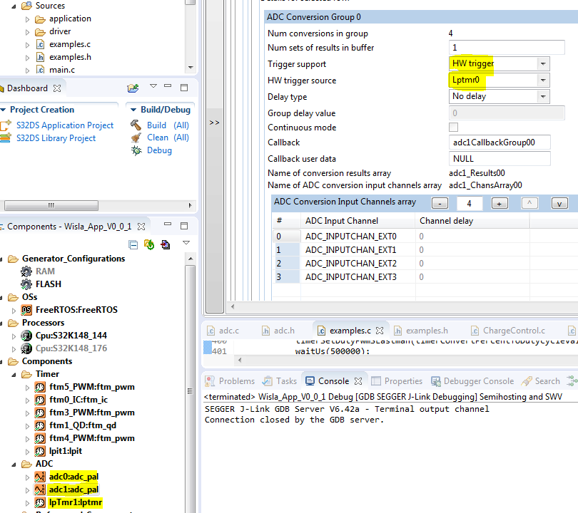

In a project I want to use the ADC_PAL component for group conversion.
For this I have have two ADC_PAL components with each a group with different adc channels.

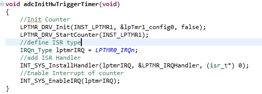

Now I want to have these two groups triggered by a LPTMR component continuously. Both adc have the same settings, but adc1 is not running.
Is it not possible to use one LPTMR instance to trigger two ADC_PAL instances?
Here you can see the start of the continuous conversion.
Thanks for your help

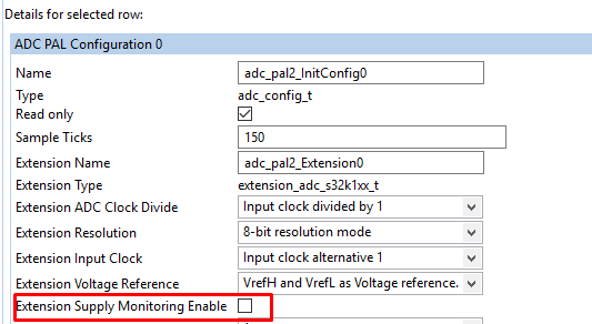

ADC_PAL supports the scenario for using LPTMR to trigger conversions in parallel on both instances of ADC. Just make sure to uncheck Extension Supply Monitoring Enable for the adc_pal configured over ADC1, to avoid the DEV_ASSERT, as already mentioned by Diana.

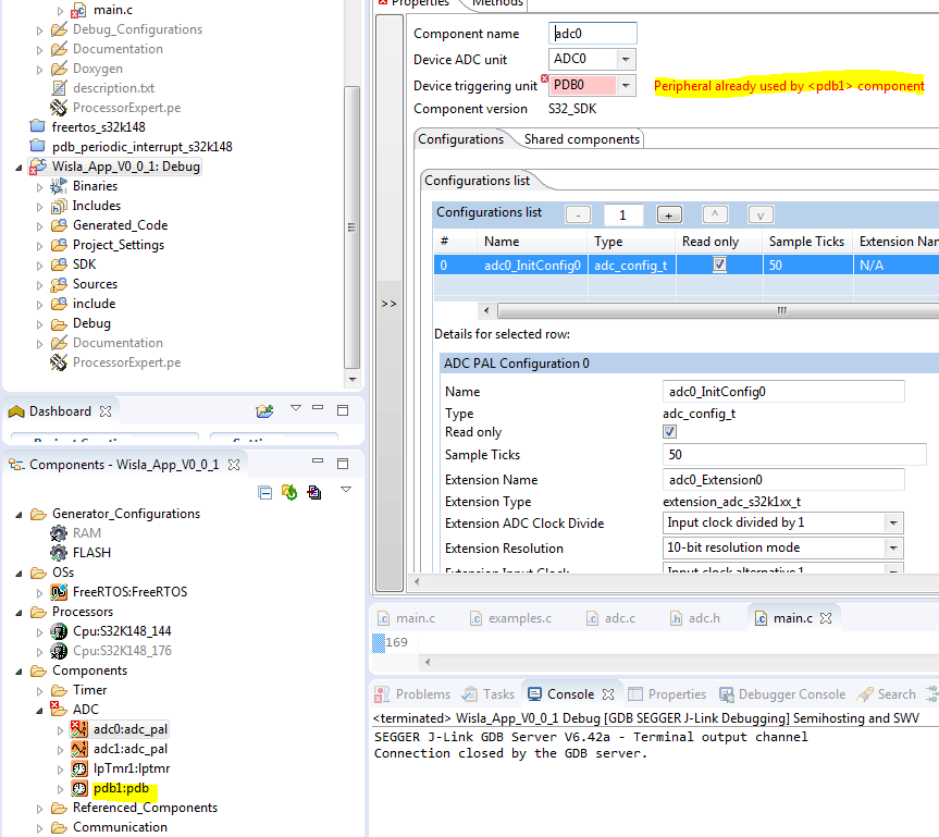

Each ADC_PAL instance already uses 1 ADC instance and 1 PDB, so it is not possible/required to add them in the project when using also ADC_PAL. The ADC_PAL uses also TRGMUX to route LPTMR signal to the PDB and ADC.
Are you configuring ADC_PAL1 on ADC0 & PDB0 and ADC_PAL2 on ADC1 & PDB1? Also make sure you are calling ADC_Init and ADC_EnableHardwareTrigger, for each instance and group.

Please, accept my apologies for the delay. I do some tests with the adc_pal_s32k144 example. I have added the second pal component and I have used the same configuration for ADC1 such as for ADC0, with device triggering unit PDB1 and with unchecked Extension Supply Monitoring Enable which is only available on ADC0.
If it is enabled for ADC1, then a DEV_ASSERT in ADC_Init() will be triggered.
Is it your issue?

For my project I use a LPTMR instance which should trigger both ADC at the same time.
With unchecked "Extension Supply Monitoring Enable" it still does not work.
Did you used a PDB Component for triggering the ADCs?
Because if I try to use a PDB instead of a LPTMR as trigger there is an error in the ADC_PAL instance that the PDB instance is already used by the PDB component:
Thanks for your feedback
