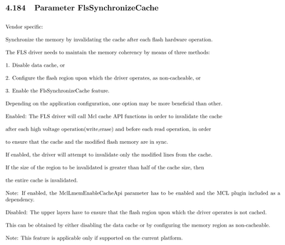

Currently, I use S32 Design Studio for S32 Platform and S32K312,
I delete "D_CACHE_ENABLE" option in the S32 Design Studio for S32 Platform.
The hard fault error happens when C40_IP_read is called like the attached file.
Could you please let me know what should I do to resolve this issue?

Hi @HyunungPark1
if data cache is disabled, you should disable cache synchronization. Could you give this a try?
Lukas
