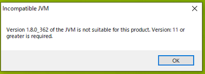

I am preparing 2nd S32DS Ver.3.5 environment but I got a message of  JVM(JAVA???) after executing s32ds.bat.
 1st  C:\NXP\S32DS.3.5
 2nd C:\NXP\S32DS.3.5_RTDxxx
Do you know how to solve it?
De we need to modify "s32ds.ini" ?
Best,
Fumi
4,293 Views
Julián_AragónM
Hi @Fumihiko_Sato,
Looking into the Java issue, it seems it is not recognizing the javaw.exe path. Does this issue also appear when opening the "s32ds.exe" file directly? Does this happen with both instances (S32DS.3.5_RTDxxx & S32DS.3.5)?
Adding the following two lines directly before the line -vmargs and adapt the path to your Java 11 or higher 64-bit Java VM installation directory may solve this issue:
-vm
C:\NXP\S32DS.3.5_RTD_4.0.0\eclipse\jre\bin\javaw.exe (or java.exe)
Julián

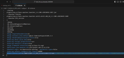

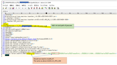

Fumihiko_Sato
Hello @Julián_AragónM ,
Thank you for your checking.
It was not enough for your advice, therefore I investigated and modified some items.
It seems like working but I have one question(Please refer to Photo1).
 ->Yes. I got the same result for s32ds.exe and s32ds.bat.
 -> No. Only for the copied S32DS.3.5_RTDxxx.
     S32DS.3.5 works correctly.
FYI

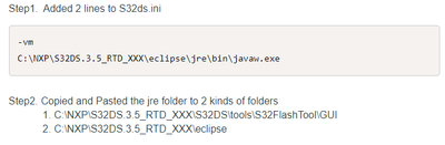

Step1.  Added 2 lines to S32ds.ini
-vm
C:\NXP\S32DS.3.5_RTD_XXX\eclipse\jre\bin\javaw.exe

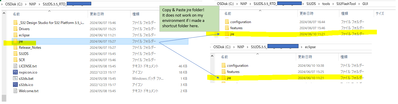

Step2. Copied and Pasted the jre folder to 2 kinds of folders
            1. C:\NXP\S32DS.3.5_RTD_XXX\S32DS\tools\S32FlashTool\GUI
            2. C:\NXP\S32DS.3.5_RTD_XXX\eclipse
Photo1. What I did  and one questionb elow.
Photo2. Copied and Pasted the jre folder to 2 kinds of folders
Best,
Fumi

Julián_AragónM
Hi @Fumihiko_Sato,
This value should be modified by the installer with the new instance's path when changing the default path in installation:
Have you copied the configuration instead of installing a new instance with the .exe installer?
4,183 Views
Fumihiko_Sato
Thank you for your support.
 -> Do you mean
this path is automatically changed with the installer?
 ->Yes. I just copied S32DS.3.5(Default) folder and modified 2 things(Photo1).
     Should I install for S32DS.3.5_RTD_XXX(2nd) using installer?
Photo1. Modified items
KInd regards,
Fumi
4,163 Views
Julián_AragónM
Hi @Fumihiko_Sato,
Yes, a new instance needs to be installed (can be done with the same installer). When installing the second instance, change the installation path to the desired name (for example: ...\S32DS_3.5_RTD400), and you can use the .exe or .bat file inside that new Design Studio.
