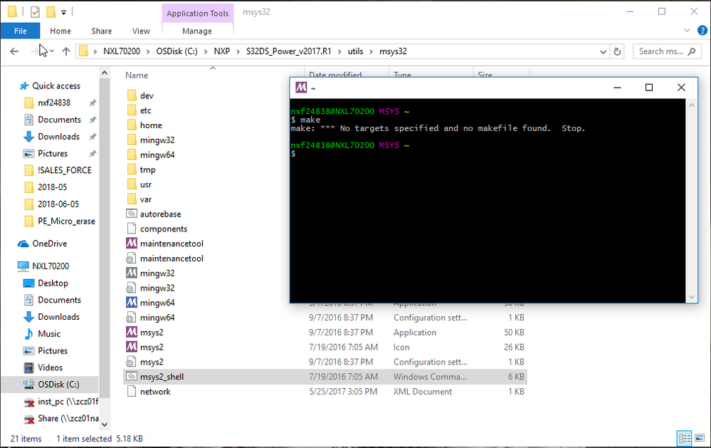

I am using S32 Design Studio 2017.R1 for my project development. When I try to build the project (Project->Build Project), I get following displayed on console window,
12:38:11 **** Incremental Build of configuration Debug for project <project name> ****
make -j4 all
Cannot run program "make": Launching failed
12:38:11 Build Finished (took 60ms)
When I check the debug folder, I found no binary or map file generated.
Please let me know for the missing project settings, if any.
Thanks in advance.

are you able run from windows console the make.exe ? It is located in
[YOUR_S32DS_INSTALL_PATH]\S32DS_Power_v2017.R1\utils\msys32\usr\bin\
Sometimes with HDD encryption are some files corrupted.
Jiri

jiri_kral
yes, the S32DDS just execute make.exe file - not exactly from windows command line, but from msys32 environment.
To be sure that there is issue with make itself - please run in msys_shell.cmd in
[YOUR_S32DS_INSTALL_PATH]\S32DS_Power_v2017.R1\utils\msys32 folder and just type make in appeared console window.  The output should look like this:
If the make doesn't work, try to reinstall your S32DS. If you aren't able even run the msys shell, it may help power off (reaal power off - not restart) your Windows 10 machine. There is some issue for heap mapping for msys caused by Win10, and physical shutdown solve it.
Jiri
