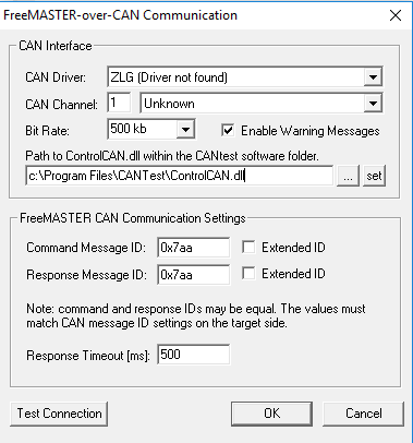

I'd suggest to add path to appropriate driver .dll (e.g. ControlCAN.dll)  and test the connection. In  my case I also do not see any driver found but FreeMASTER works just fine with my ZLG compatible device.
make sure there is no other application using ZLG device at the moment you are trying co use it in FreeMASTER.
hope it helps.
Stan.
