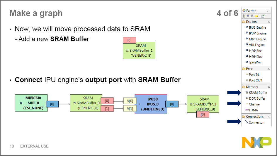

This tutorial walks a user through the steps to create a new application for the S32V234 MCU using S32DS (with S32V2xx development package and Vision extension package for S32V2xx) and the built in ISP Visual Graph tool. The completed application will take an image from camera, processes it on ISP and put the processed image in DDR buffers. Once the image is in DDR buffer, host (A53 core running Linux) will direct the display control unit (DCU) to display it on screen.
Prerequisites:
  • Some knowledge of the S32V234 System on a Chip (SoC)
  • Have an understanding of the ISP architecture
  • Be familiar with the NXP Vision SDK software
