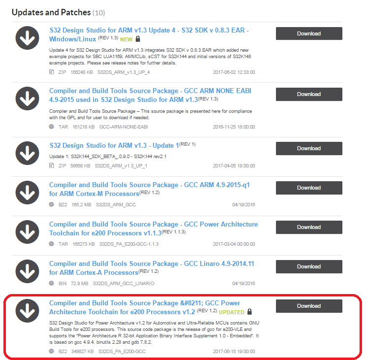

GCC source code for the provided binaries?
I'm lazy, so before going to v1.2 full install, I'd like to be sure...

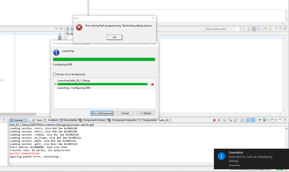

I'm having problems flashing MPC5748G using V1.2...
Example still working in V1.1..

Hi Jed,
Thanks for the notification!
GCC Source Code package is available in the download section now.
Stan
Ludwig,
I'm having similar troubles getting things flashed with 1.2. Both in the Eclipse environment and in my own command line flashing utility [GitHub - jed-frey/opensda_flasher].
I believe it's an issue stemming from the new version of the PEMicro GDB server which has been upgraded. I didn't want to say anything until I had proper time to investigate but could you try replacing the PEMicro executable with the older one from 1.1?
It's here:
eclipse\plugins\com.pemicro.debug.gdbjtag.ppc_xxxxxxx\win32\pegdbserver_power_console.exe
I'm away from my bench this week, but from what I remember there were additional init steps in the newer version which I think is causing the GDB client to timeout and fail.
Other things that I'd like to, but haven't, tried are changing the speed or having it not reset the micro when it attaches.

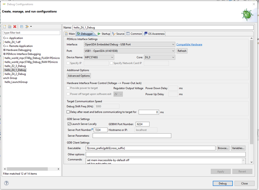

I tried your suggestion and running into strange issues. For one, IVOR2_Vector() is a dead end it seems, stepping is not possible. pe/gdb also complains about a password setting, never seen before and not working from this point. I re-installed the old drivers from ./Drivers/PEDrivers_install.exe but no success. At 98%, programming of Flash/Ram starts, which was not the case before.
Any ideas? Enjoy weekend.

I got some more time to mess around with it. I definitely think it's something with the new version of the GDB server and not the driver.
I had the old and new versions side by side and continually got errors like this with the new version:
The old version seemingly worked fine.
Additionally I cannot find any documentation on the GDB server's commands such as what 'preserve' does or how the 'selectcore' and 'multimode' monitor commands work.  Google doesn't turn up anything since this is the only software tools where the commands seem to be used.
