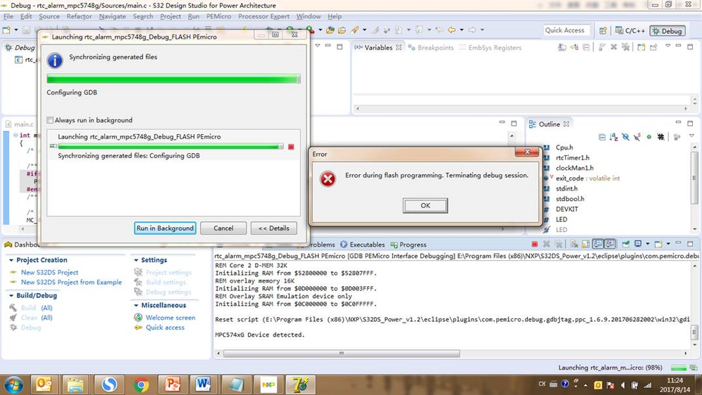

I've tested the problem on 6 different PCs several times and I find that I can not download my code to MPC5748G using S32DS v1.2 when I am going to debug , but I can do it using S32DS v1.1. Even every time it stops at 98%.
The error log prompts
Loading programming algorithm ...
Error loading programming algorithm - load aborted.
Error occured during Flash programming.
I don't know why ? How can I solve the problem?

v1.2: every time it stops at 98%, then error message appears; But it success to debug if I use RAM mode instead of FLASH mode;
The following is screenshot:

Hi Martin,
This issue maybe related to firmware of board DEVKIT-MPC5748G when using OpenSDA connection to debug, It is not compatible with new version of P&E plugin.
You could update new firmware for DEVKIT-MPC5748G by using DEBUG-OPENSDA-E200_Pemicro_v110.SDA file
(download OpenSDA Firmware (MSD & Debug). Updated June 28th, 2017. at link "http://www.pemicro.com/opensda/".)
You could try this way to solve your problem.
Hoa

Hope the following reply will help you solve your problem.
Your MCU may be locked. Pls try to erase all the flash of the MCU mpc5748g.
Originally I am not sure about your problem. One of my friends meets the same problem with you. Although he uses devkit-mpc5744p, his debug progress is stuck in 98%. Finally
I find out that the mcu had been locked since he pulled out when debugging. Especially, he can debug in debug_RAM mode, but fail to debug in debug_flash mode.
Then I use cyclone universal read all flash memory data and write back the data into the memory. Now the mcu works out well.

fortunely
Hi, Hoa Ta Thi
Yes, you're right. I've solved the problem by updating the firmware. Thanks.
