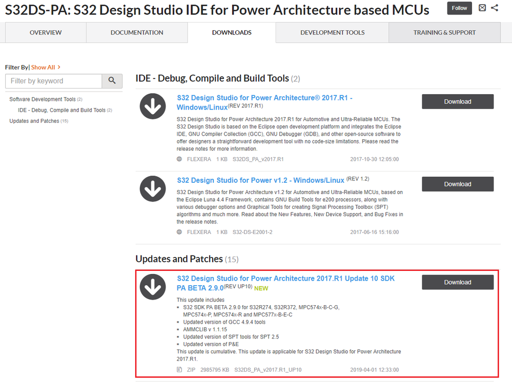

    • go to S32 Design Studio for Power product page -> Downloads section or use direct link to download the update archive zip file pastedImage_14.png

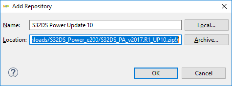

      • Add a new "Archive" repository and browse to select the downloaded update archive zip file you downloaded in the previous step

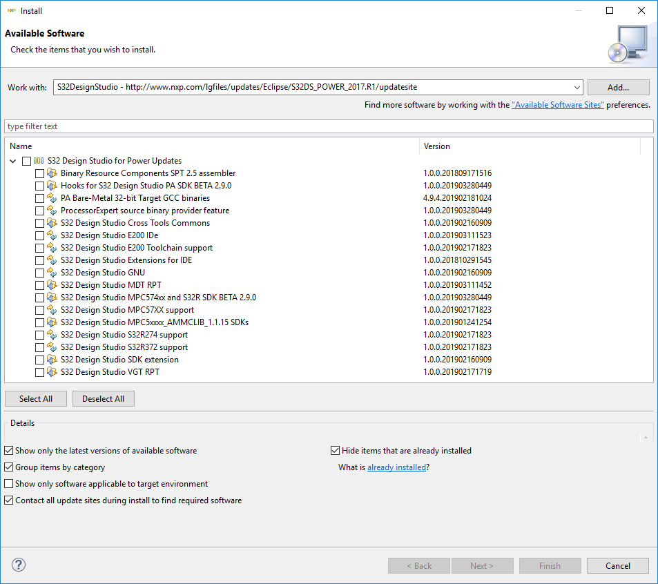

      • Select all available items and click "Next" button.
This will start the update installation process.

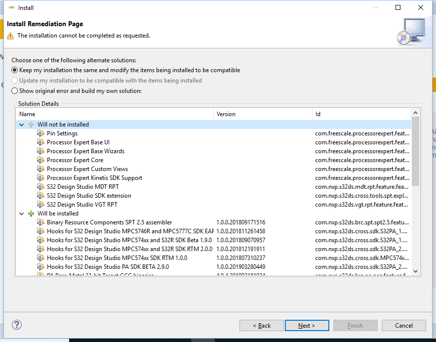

When performing the above steps for online installation, selecting all components for update, I get a number of warnings, saying that certain components will not be installed.
Is that OK?

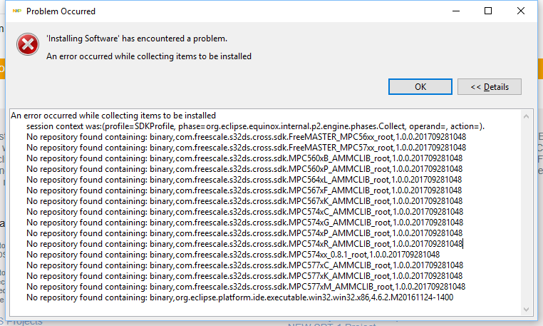

I started the install that had the warnings and got an installation error:
So we cannot install the update.  What are our options?  We wanted to install the update to prevent 'reset escalation' problems discussed in many places in this forum.
Finally I tried the offline-install.  This fails with the same error as above.
I performed a deinstallation of the system.
Then a new installation, but this time I kept the default settings for the installation position.
This worked without any errors.
(When I did the first install, I Installed to 'c:\Program Files\NXP' instead of the default C:\NXP.)
