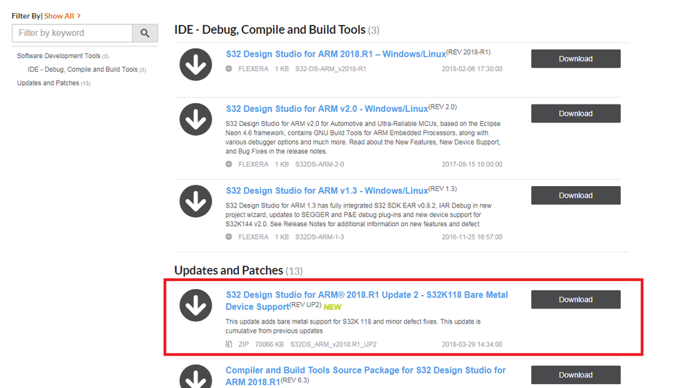

    • go to S32 Design Studio for ARM product page -> Downloads section or use direct link to download the update archive zip filepastedImage_1.png

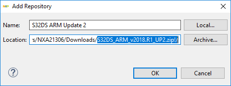

    • Start S32DS and go to "Help" -> "Install New Software..."
    • Add a new "Archive" repository and browse to select the downloaded update archive .zip file you downloaded in the previous step

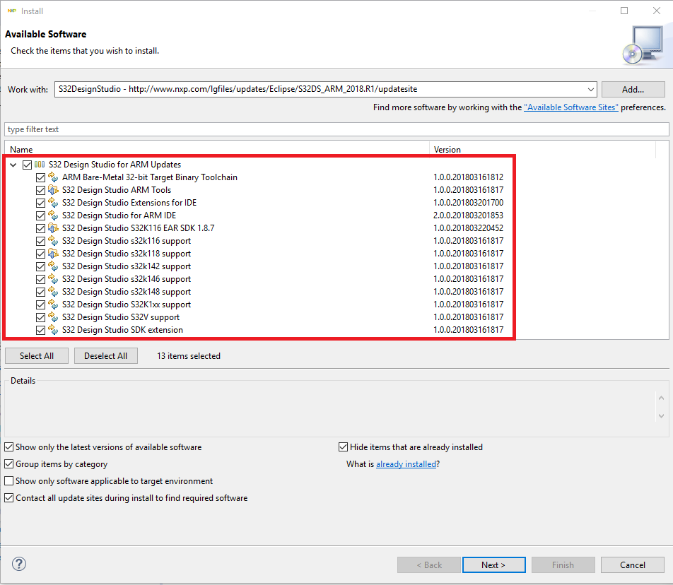

    • Select all available items and click "Next" button.
This will starts the update installation process.
