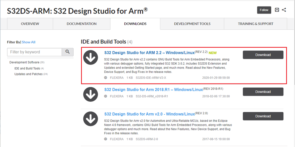

The Automotive Processing's Embedded Tools Team at NXP Semiconductors is pleased to announce the release of the S32 Design Studio for Arm® v2.2.  Here are some of its major features:
  • GNU Bare-Metal Targeted Tools for Arm® 32-bit Embedded Processors (GCC version 6.3.120170509, revision g7fea41d)
  • GNU Tools for Arm® Embedded Processors (Launchpad) (GCC version 4.9.3 20150529,revision 227977)

Please visit the S32 Design Studio for ARM product page - download section or direct link to download the installer.

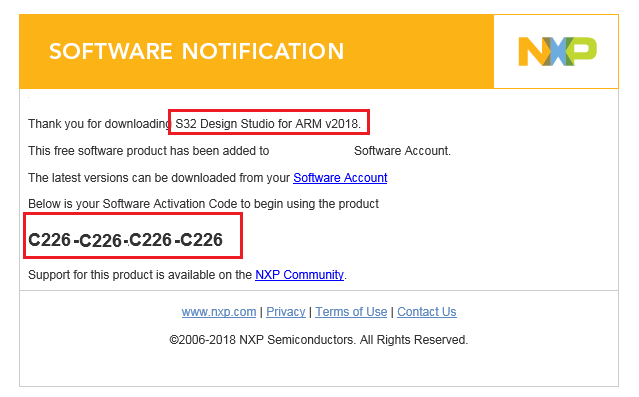

The installer requires the NEW Activation ID to be entered during the installation.
You should receive an email that includes your Activation ID after starting the download.
