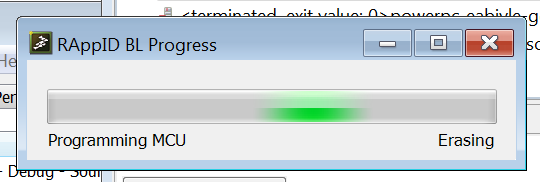

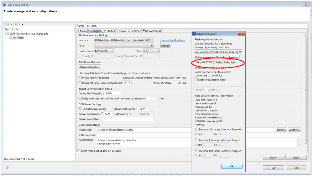

Looks like I had some settings incorrect out of the box in the IDE, which is a fresh install on this machine for this project.  I did attempt to program .rbf / .srec files (via both PROGPPCNEXUS and S32DS environments) and received similar errors pertaining to memory addressing.  I see from your release notes that the bootloader occupies 0x00020000 - 0x0002FFFF.  As you can see from the PROGPPCNEXUS screen cap, I get invalid memory addresses (similar response from S32DS).  This is with both methods using NXP_MPC5777C_1x32x2048k_CFlash_highspeed.pcp algorithm, which is the default in the S32DS IDE.
Now, when I change the algorithm to NXP_MPC5777C_Cflash_Dflash_highspeed.pcp and flash your MPC5777C_S32DS_UART0_CAN0_1sec_delay.rbf file via S32DS, the rbf sticks and it appears to have worked.  I will say that I had much better luck with your 1sec delay rbf than the other native when it comes to getting the timing right between physical module reset and the RAppID BL process' reset timing idiosyncrasies.  For the benefit of others, here's where to make and verify that change in S32DS:
After this, it's smooth sailing when building in Simulink and programming via USB-to-Onboard Serial (not via the PEMicro FX JTAG) onto the MPC5777C-416DS daughter card.

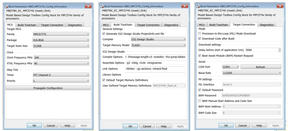

Simulink settings below for continuity:
