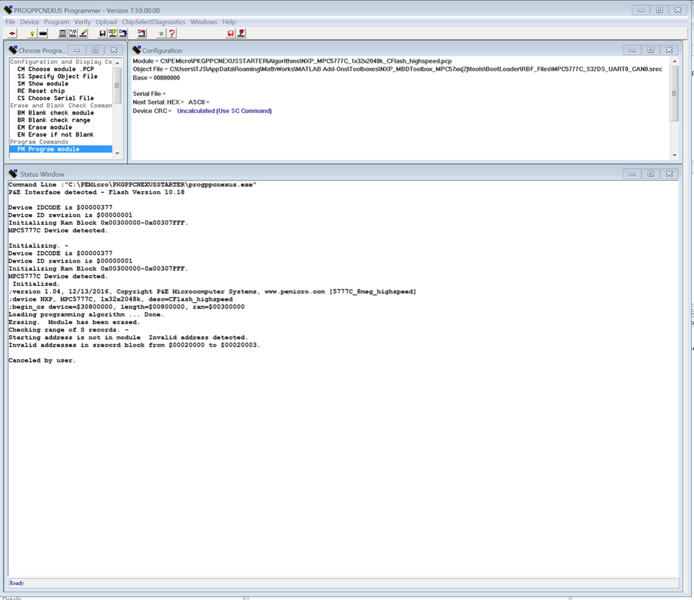

mikedoidge‌ Hoping you could point us in the right direction.. Wondering if there is an OpenSDA rbf file available for the setup below...
We are using the following:
  • MPC57xx Motherboard Rev C
  • MPC5777C-416DS  Daughtercard
  • S32DS Environment
  • PE Micro Multilink Universal FX connected at JTAG J31
  • MBD Toolbox for Matlab / Simulink
Using the files for the 5777C that you attached above, the boot loader doesn't connect via the FX device.  If we use one of the available SDA rbf files for MPC574xP with OpenSDA, we seem to be able to at least talk to the target and flash a boot loader.
Ultimately the goal is to be able to integrate with the upcoming MBDT 3.2.0 release with this development setup.
Thx in advance.
Tom

Looks like I had some settings incorrect out of the box in the IDE, which is a fresh install on this machine for this project.  I did attempt to program .rbf / .srec files (via both PROGPPCNEXUS and S32DS environments) and received similar errors pertaining to memory addressing.  I see from your release notes that the bootloader occupies 0x00020000 - 0x0002FFFF.  As you can see from the PROGPPCNEXUS screen cap, I get invalid memory addresses (similar response from S32DS).  This is with both methods using NXP_MPC5777C_1x32x2048k_CFlash_highspeed.pcp algorithm, which is the default in the S32DS IDE.
Now, when I change the algorithm to NXP_MPC5777C_Cflash_Dflash_highspeed.pcp and flash your MPC5777C_S32DS_UART0_CAN0_1sec_delay.rbf file via S32DS, the rbf sticks and it appears to have worked.  I will say that I had much better luck with your 1sec delay rbf than the other native when it comes to getting the timing right between physical module reset and the RAppID BL process' reset timing idiosyncrasies.  For the benefit of others, here's where to make and verify that change in S32DS:
