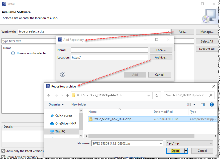

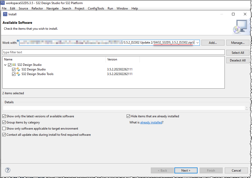

2. Download and Install S32 Design Studio 3.5 Update 2 D2302: SW32_S32DS_3.5.2_D2302.zip  (com.nxp.s32ds.update_3.5.2.20230227110156)

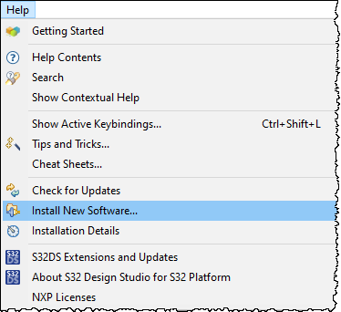

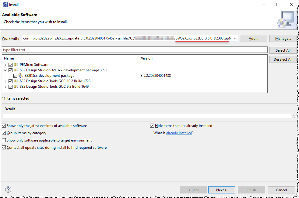

3. Click S32K3 Standard Software -> Automotive SW - S32K3 - S32 Design Studio

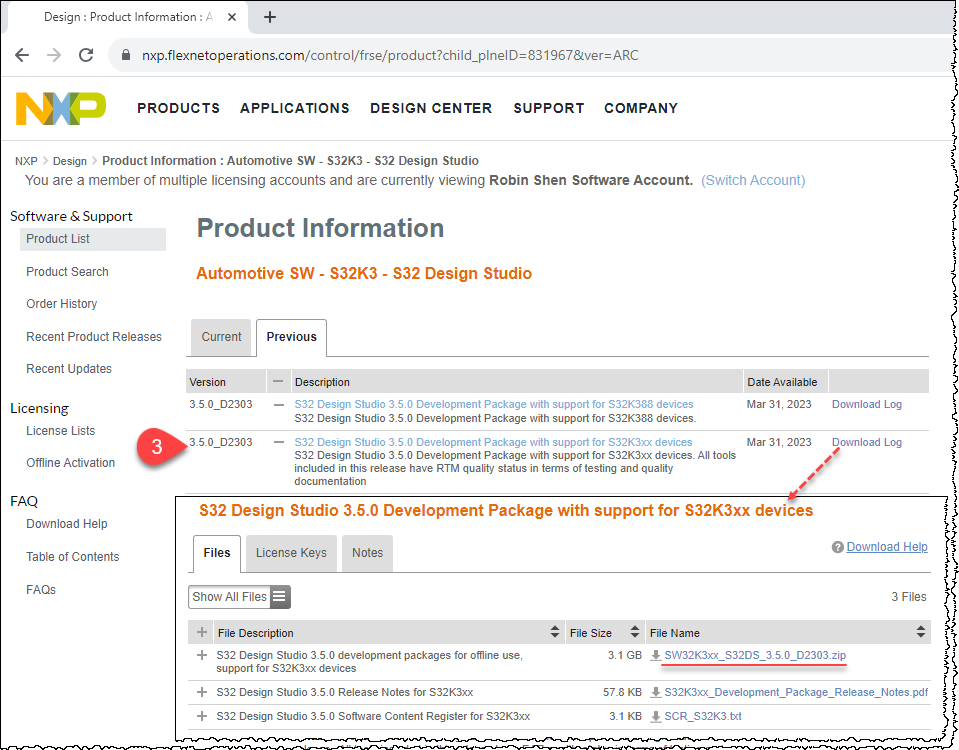

Download and Install S32 Design Studio 3.5.0 Development Package with support for S32K3xx devices(3.5.0_D2303): SW32K3xx_S32DS_3.5.0_D2303.zip  (com.nxp.s32ds.sp1.s32k3xx.update_3.5.0.20230405175452)

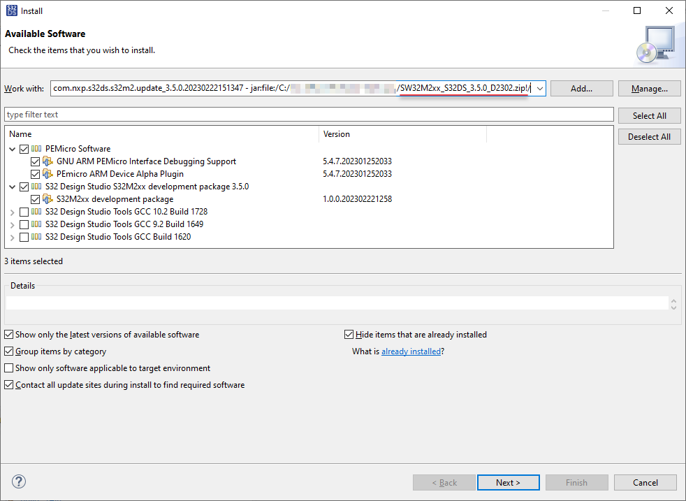

5.a) For users who need to install S32M276 RTD in S32K3 RTD 3.0.0\P01\P01 HF01\P01 HF02 for development, please download and install S32 Design Studio Service Pack 2 CD with support for S32M2xx devices (3.5.0_D2302 SW32M2xx_S32DS_3.5.0_D2302.zip(com.nxp.s32ds.s32m2.update_3.5.0.20230222151347
Note: Please contact your local FAE to enable for you download the S32M276 development package.
step5. Install development package for S32M276 SW32M2xx_S32DS_3.5.0_D2302.png

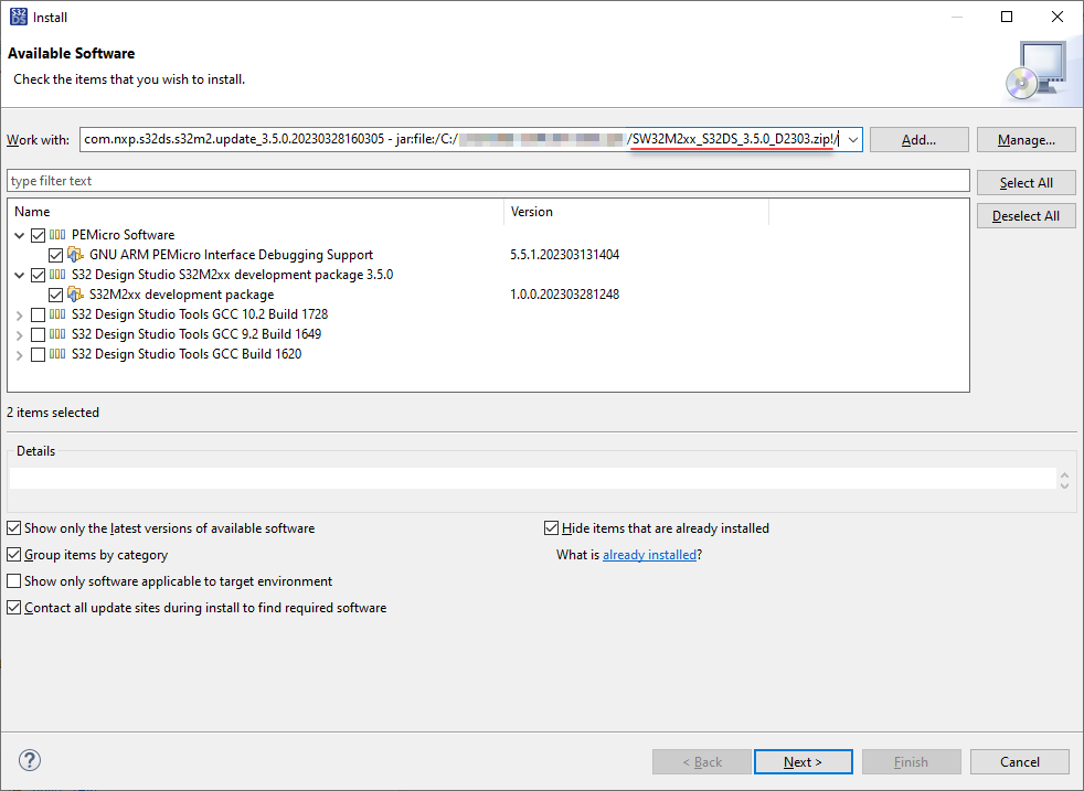

5.b) For users who need to install S32M276 RTD in S32K3 RTD 3.0.0 P07 for development, , please download and install S32 Design Studio Service Pack 2 EAR2 with support for S32M2xx devices(3.5.0_D2303 SW32M2xx_S32DS_3.5.0_D2303.zip(com.nxp.s32ds.s32m2.update_3.5.0.20230328160305)
step5. Install development package for S32M276 SW32M2xx_S32DS_3.5.0_D2303.png

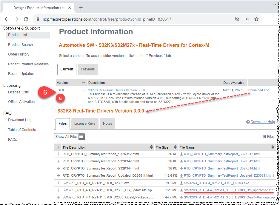

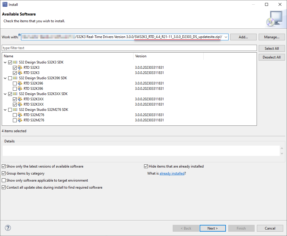

6.a) Download and install S32K3 Real-Time Drivers Version 3.0.0: SW32K3_RTD_4.4_R21-11_3.0.0_D2303_DS_updatesite.zip
Step6 Download SW32K3_RTD_4.4_R21-11_3.0.0_D2303_DS_updatesite.zip.pngstep6. Install S32K3 RTD 3.0.0.png

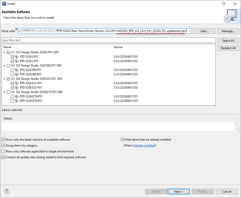

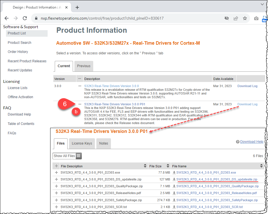

6.b) Download and install S32K3 Real-Time Drivers Version 3.0.0 P01 : SW32K3_RTD_4.4_3.0.0_P01_D2303_DS_updatesite.zip
Step6 Download SW32K3_RTD_4.4_3.0.0_P01_D2303_DS_updatesite.zip.pngstep6. Install S32K3 RTD 3.0.0 P01.png

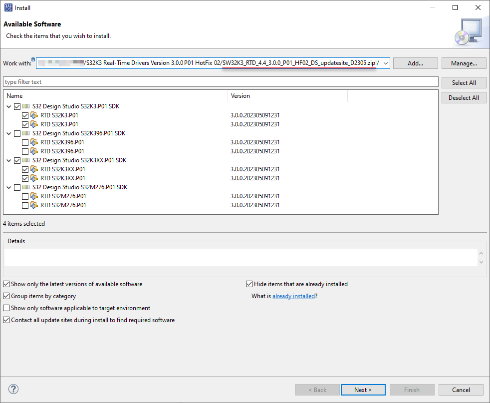

6.c) Download and install S32K3 Real-Time Drivers Version 3.0.0 P01 HotFix 02 (3.0.0_P01_HF02 SW32K3_RTD_4.4_3.0.0_P01_HF02_DS_updatesite_D2305.zip
Step6 Download SW32K3_RTD_4.4_3.0.0_P01_HF02_DS_updatesite_D2305.zip.pngstep6. Install S32K3 RTD 3.0.0 P01 HF02.png

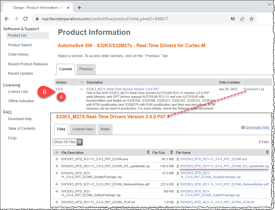

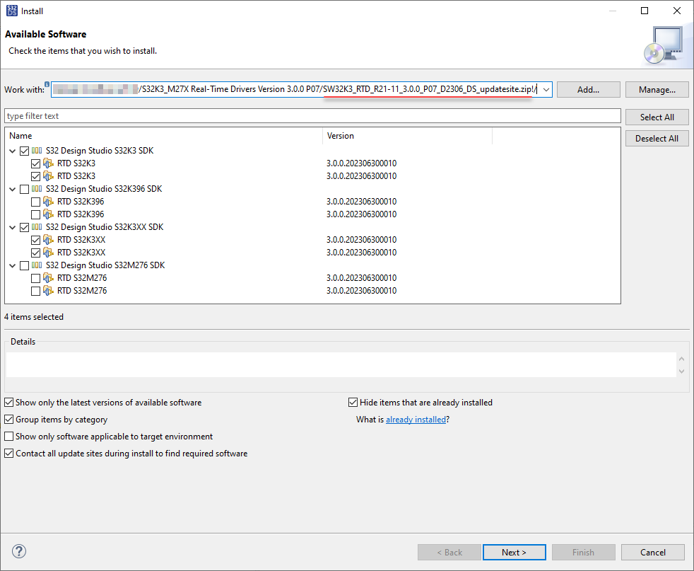

6.d) Download and install S32K3_M27X Real-Time Drivers Version 3.0.0 P07SW32K3_RTD_R21-11_3.0.0 _P07_D2307.zip
Step6 Download SW32K3_RTD_R21-11_3.0.0_P07_D2306_DS_updatesite.zip.pngstep6. Install S32K3 RTD 3.0.0 P07.png
