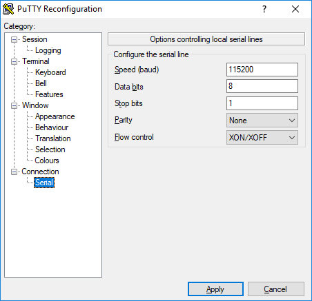

3) Set Connection type to Serial
4) Set speed to 115200, Data bits 8, Stop bits 1, Parity None
5) Set Serial line to the COM port associated with the USB port setup in step 1 of this document. (for ex. COM3)

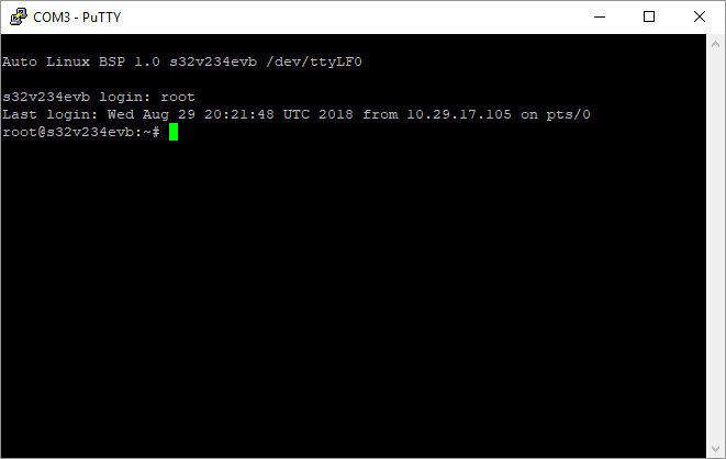

6) Click Open to start the terminal session
7) Press enter key to bring up login prompt
8) Log into Linux (login name is "root")

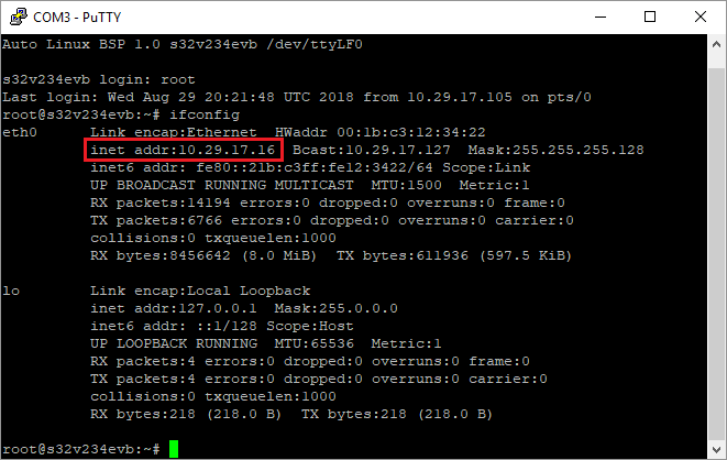

10) Get IP address, enter command:
   ifconfig
      Make note of the IP address

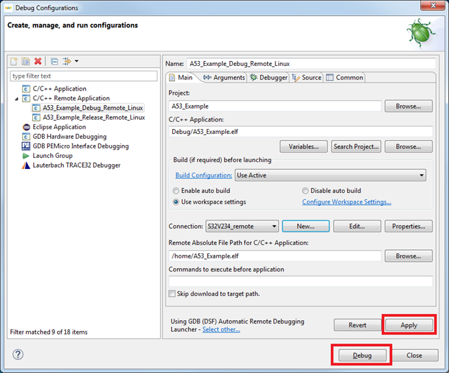

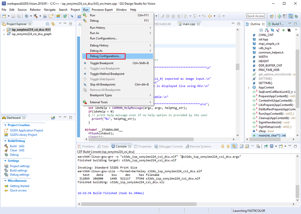

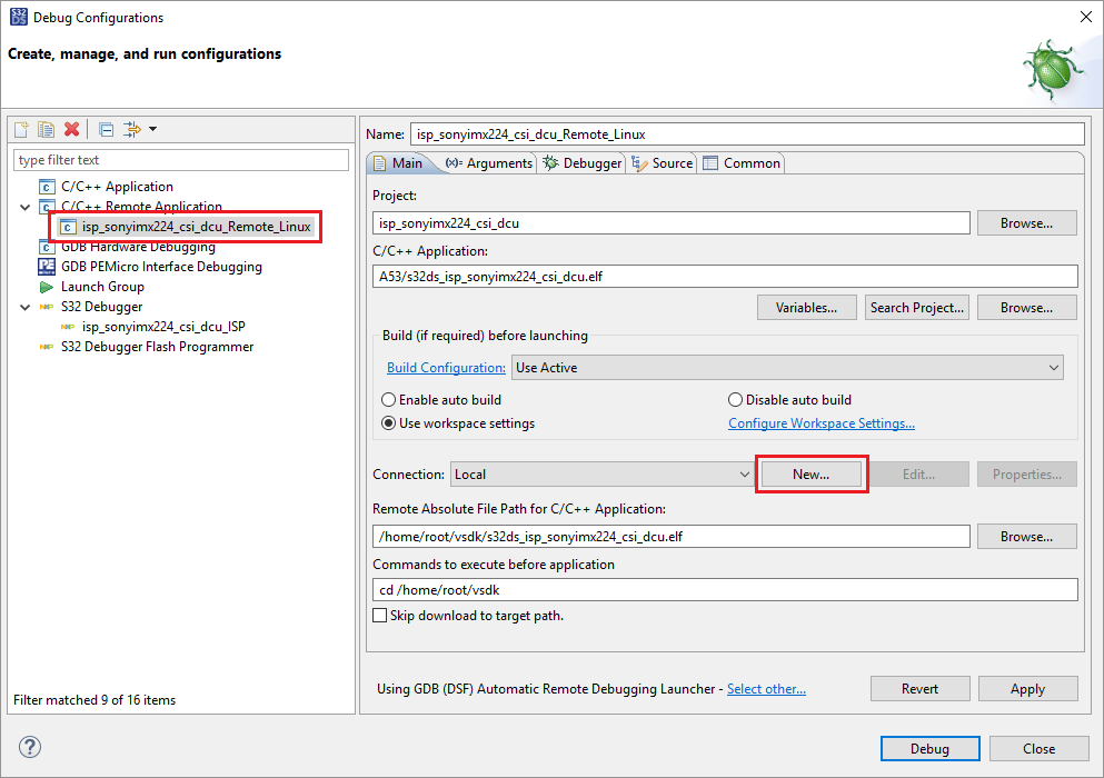

11) Launch S32DS for Vision. From the C/C++ Perspective, select Run->Debug Configurations...
12) From 'C/C++ Remote Application'. Select '<project_name>_Remote_Linux' debug configuration.
13) Select New to create new debug connection.

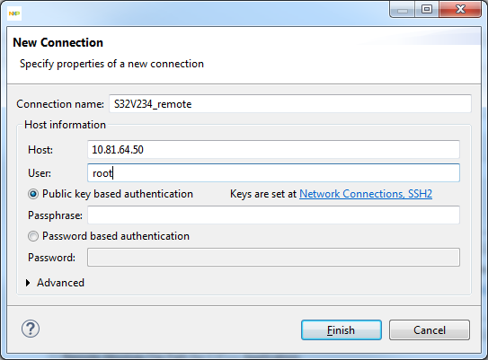

14) Select SSH
15) Enter the IP address noted earlier
16) Enter user ID as "root". The Linux BSP uses Password based authentication, but by default, no password is set. So the password can be left blank.
17) Select Finish
19) Select Apply, and then if you wish, Debug
