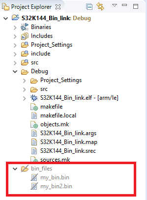

The first step is to add the binary file(s) into your project folder in the workspace.
In the example below I created two binary files "my_bin.bin" and "my_bin2.bin" and added them into a custom folder "bin_files".
I also entered 10 characters into each file.
my_bin.bin: 0x41 0x41 0x41 0x41 0x41 0x41 0x41 0x41 0x41 0x41  (represents 10 characters "A")
my_bin2.bin: 0x42 0x42 0x42 0x42 0x42 0x42 0x42 0x42 0x42 0x42  (represents 10 characters "B")

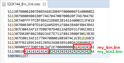

After successful compilation and link let's check map and s-record file (HOWTO: Generate S-Record/Intel HEX/Binary file ) to confirm the binary files have been linked correctly:
.glue_7t 0x0000080c 0x0 linker stubs
 *(.eh_frame)
 *(.init)
 *(.fini)
 0x0000080c . = ALIGN (0x4)
 ..\bin_files\my_bin.bin()
 .data 0x0000080c 0xa ..\bin_files\my_bin.bin
 0x0000080c _binary____bin_files_my_bin_bin_start
 0x00000816 _binary____bin_files_my_bin_bin_end
 ..\bin_files\my_bin2.bin()
 .data 0x00000816 0xa ..\bin_files\my_bin2.bin
 0x00000816 _binary____bin_files_my_bin2_bin_start
 0x00000820 _binary____bin_files_my_bin2_bin_end
.vfp11_veneer 0x00000820 0x0
 .vfp11_veneer 0x00000820 0x0 linker stubs‍‍‍‍‍‍‍‍‍‍‍‍‍‍‍‍‍‍‍‍‍‍‍‍‍‍‍‍‍‍‍‍‍‍‍‍‍‍‍‍‍‍‍‍‍‍‍‍‍‍‍‍‍‍‍‍‍‍‍‍‍‍‍‍‍‍‍‍‍‍‍‍‍‍‍‍‍‍‍‍‍‍‍‍‍‍‍‍‍‍‍‍‍‍‍‍‍‍‍‍‍‍‍‍‍‍‍‍‍‍‍‍‍‍‍‍‍‍‍‍‍‍‍‍‍‍‍‍‍‍‍‍‍‍‍‍‍‍‍‍‍‍‍‍‍‍‍‍‍‍‍‍‍‍‍‍‍‍‍‍
