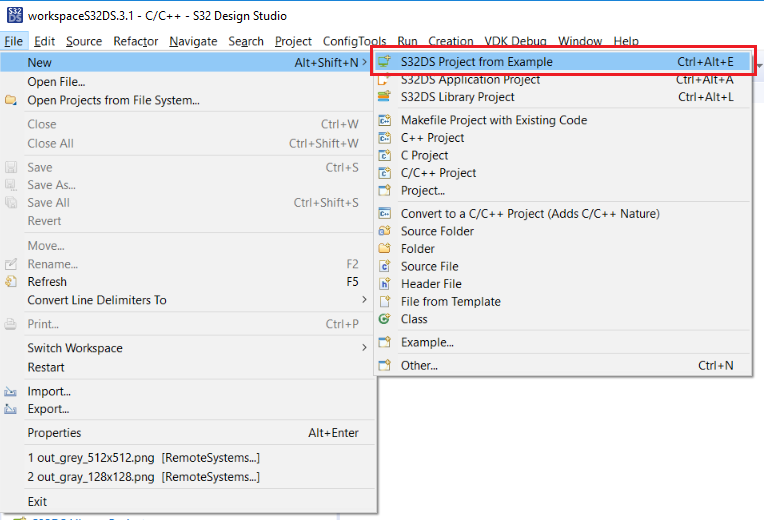

1) Launch S32DS
2) Select 'New S32DS Project from example'

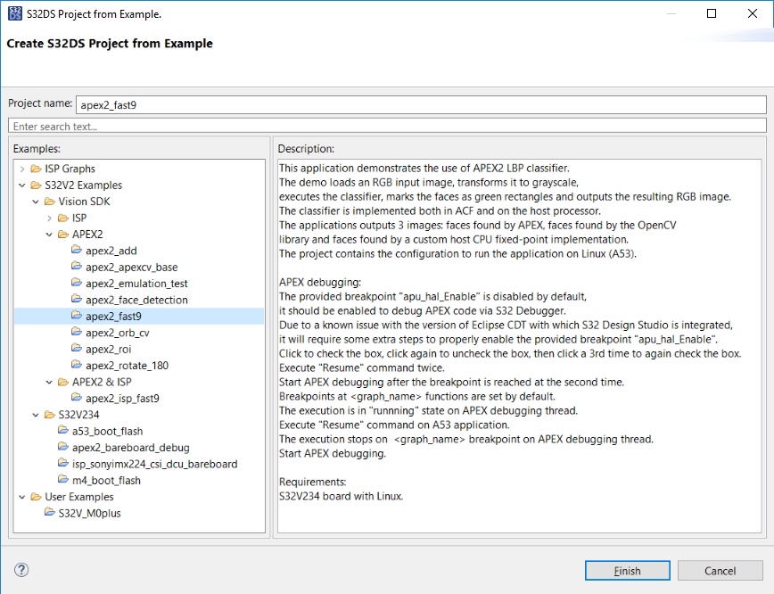

3) Select apex2_fast9 project
4) Click Finish

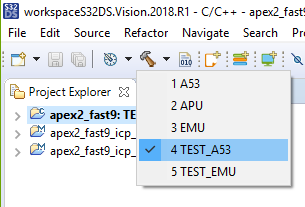

5) Select apex2_fast9: A53 in the Project Explorer panel. Build the project using build config 'TEST_A53'.

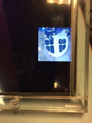

  • Should see something similar to what is pictured below
  • There are green diamonds at the corners in the image as identified by the fast9 corner detection algorithm
