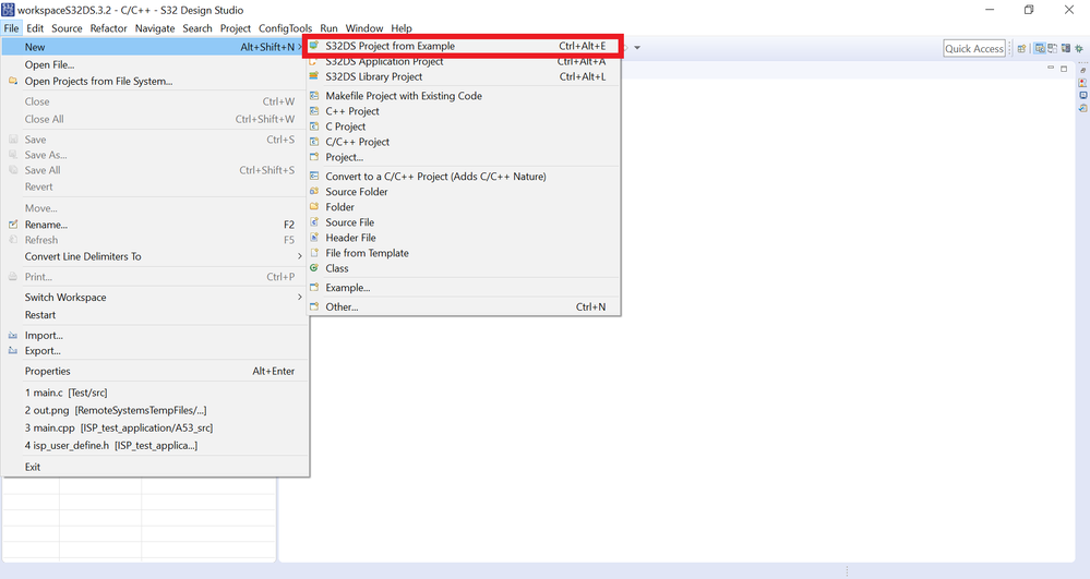

2) Select 'File -> New -> S32DS Project from Example'

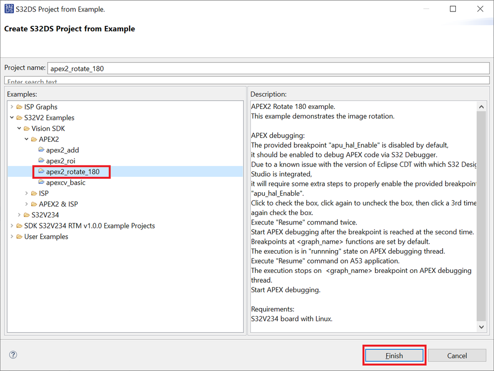

3) Select apex2_rotate_180 project
4) Click Finish

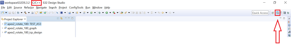

5) If not in the C/C++ Perspective, switch over by clicking on the icon showed below (Hovering over the correct icon should display 'C/C++'). The current perspective is displayed on the top bar.

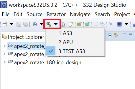

6) Select apex2_rotate_180: A53 in the Project Explorer panel. Build the project using build config 'TEST_A53'.

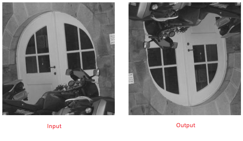

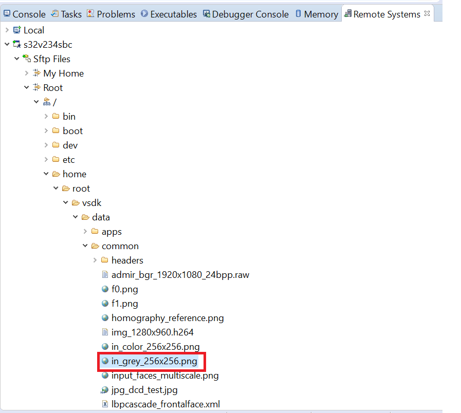

  • The program takes the input image  in_grey_256x256.png located in the /home/root/vsdk/data/common folder on the Linux BSP and rotates it 180 degrees
  • The output image out.png is located inside the /home/root/vsdk folder
9) To see the output, access the device from the remote systems view. If this has not been set up, complete the steps described in HOWTO: Access Linux BSP file system on S32V234-EVB from S32DS for Vision
10) Open both the input and output files from the remote systems view to verify that the program ran correctly.
