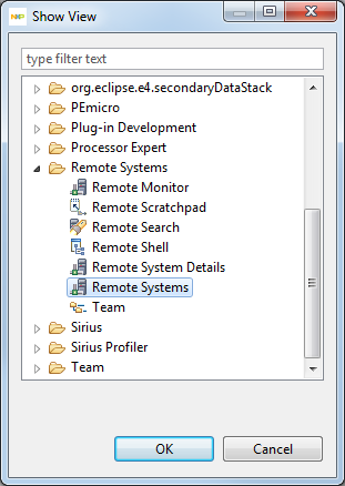

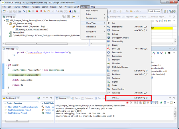

1) Go to 'Window -> Show View -> Other'
2) Expand 'Remote Systems', then select "Remote Systems' and click OK

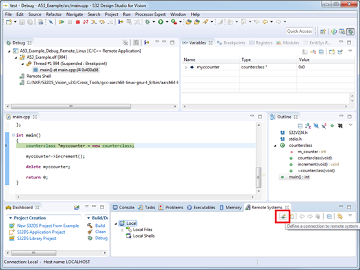

3) Click 'Define a connection to remote system' button OR right-click in the Remote Systems window and select 'New -> Connection' from the list

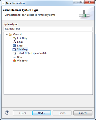

4) Select 'SSH Only'
5) Enter the IP address noted from HOWTO: Setup A Remote Linux Connection for Host name and click Finish

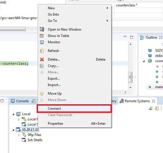

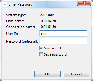

6) Right-click on the connection name in the Remote Systems window and select 'Connect' OR expand the folders under the connection name until the login window appears: Connection_name -> Sftp Files -> Root (window appears)
7) Enter "root" for User ID
8) Click OK

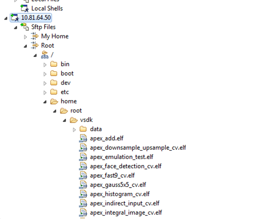

9) The Linux file system is now visible in the Remote Systems window. You can drag and drop files to and from here.
