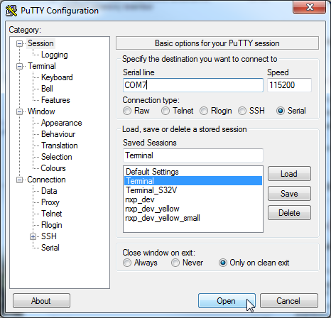

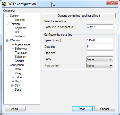

Application based on FreeRTOS S32DS example performs prinf/scanf functionality
in FreeRTOS. Application runs in two modes - standard run-time mode with two tasks
maintained by scheduler and command mode implementing basic memory monitor.
Application was tested with putty terminal (http://www.putty.org/).
Putty serial terminal settings: 115200 8N1, no HW control.

Putty configuration:

Hi Jiri,
Try your project, printf function is ok, but cannot type in command in command mode?
I don't konow why, I am using the S32K144 EVB and use usb to serial port cable.
what terminal you are using? In RealTerm - RealTerm: Serial/TCP Terminal - Browse /Realterm/2.0.0.70 at SourceForge.net
is input working okay.
Jiri
I use putty:
If I remember it correctly - in putty you need to setup the end character. So - you can give a chance to RealTerm - this one works out of box.
Jiri
I tried fresh Putty install, and for me it also works out of the box:
Here is my putty settings:
Jiri
