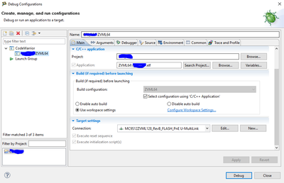

Hi Team,
I am using NXP S12ZVML64 MCU board and using Codewarrior 10.7 IDE ,
i have created one workspace in which i have changed the configuration
for workspace 1 and Debug configuration i have selected as below :
Step1::
Step2::
then i am saving the setting and flashing the code to MCU through debug option.
Can you please let me know which file of Codewarrior project contains these debug configuration setting if i have to check.

If I understand your question correctly you are asking where are the settings from "Advance Programming Options" stored in your project
Please search for the xml file that stores connection details:
 <Your S12Z Project Path>\ReferencedRSESystems.xml
 see below the snippet of the file with preserve ranges:
<property key="propertySet.[com.pemicro.mcu.debug.connections.pne.s12z].com.pemicro.mcu.debug.connections.pne.s12z.PEDEBUG_ALTERNATIVE_ALGORITHM_CHECKBOX" value="0"/>
