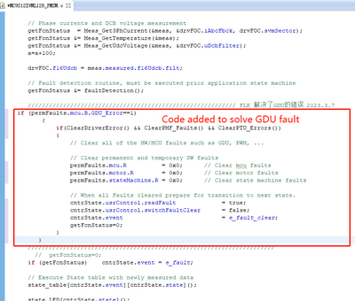

    Some problems occurred during the use of MACT, resulting in the motor not rotating I want to know where the problem is. The specific description of the problem is as follows:
1)When I used MACT to debug the motor, the development board reported the GDU fault.
2)This problem cannot be solved by using the fault clearing button in MACT. Because I reprogram PMFreeloadA_ In the ISR (void) function, a piece of code was imposed to solve the problem. Now GDU has no fault, but I don't know whether the code I wrote is appropriate?

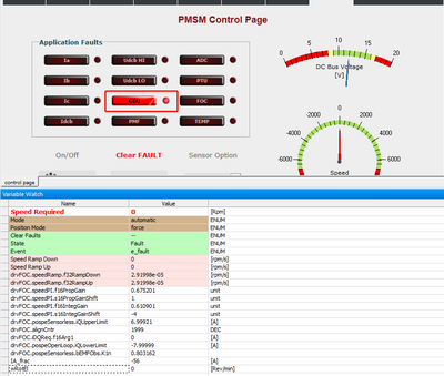

3)When I connect to MACT again, there is no GDU fault, but FOC fault. I don't know what causes this fault, so I want to seek your help.
I want to seek help to get the correct use of MACT.
