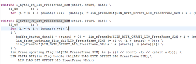

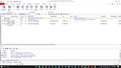

Hi, I'm using Lin Stack For S12 ECU. Earlier I've used it for getting and setting scaler values of signal. But now I want to use it for arrays.
I've created LDF and NPF for the same and it is working fine PFA
Now, I want to know how to use the read and write API of array to get and set values PFA
Is there any example or reference code for the same

Hi itsnewforme,
You can use those defines with transmitting into arguments:
start: the start element of array.
count: the number of element.
data: array save data.
