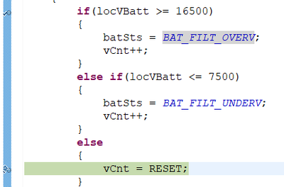

Looking at the previous code example (I put numbers), the starting condition is the following:
so putting a brekpoint it enters in the correct branch.

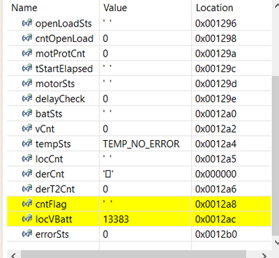

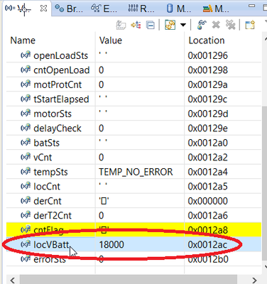

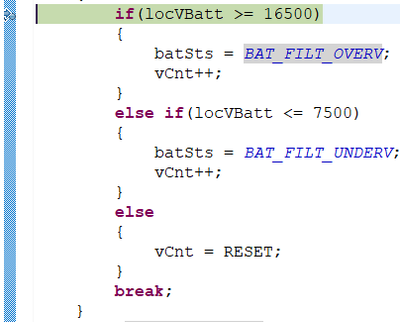

Then
if I try to change the value of the variable AFTER stopping the code with a breakpoint and advancing step-by-step the software seems to ignore the new value and continues to enter the previous branch:
