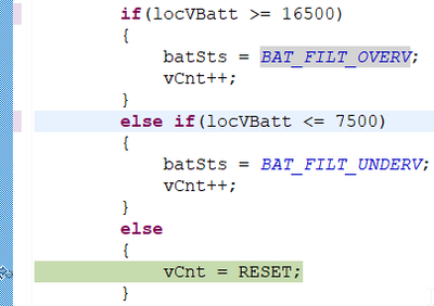

Hi all,
I inherited a project to develop and I have a problem with debugging.
When I put a breakpoint (or do "suspend") the software does not resume working properly.
I give an example with the code:
if(locVBatt >= VBATT_MAX_OFF)
batSts = BAT_FILT_OVERV;
vCnt++;
else if(locVBatt <= VBATT_MIN_OFF)
batSts = BAT_FILT_UNDERV;
vCnt++;
else
vCnt = RESET;
I put a breakpoint inside the first "if" (let's say it's "true"), then restart code execution. The brekpoint continues to run ad always enters the first branch.
Then I move the brekpoint into the "else if", change the conditions so that it is "true" but never enters the "else if" but continues to enter the first "if".
Obviously if I create the conditions that it is true the "else if" at the first execution works correctly.
Same thing if instead of a brekpoint I make a normal "suspend" during the run.
It just seems that the software does not resume working properly, I have never seen such behavior and I really don't know how to fix it.
Thank you very much to those who can help me

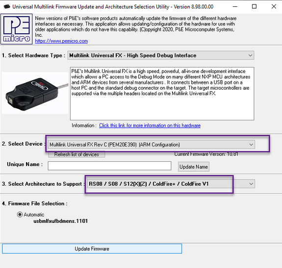

Have you tried updating the PE Micro Multilink drivers
and the firmware of the probe?
https://www.pemicro.com/products/product_viewDetails.cfm?product_id=15320180&productTab=4
5,742件の閲覧回数
buch2001
I did but nothing changed.
There seems to be some configuration options, but I don't know which ones....

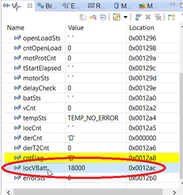

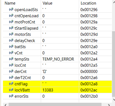

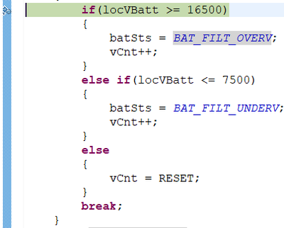

I just add a little information that might be helpful:
Looking at the previous code example (I put numbers), the starting condition is the following:
so putting a brekpoint it enters in the correct branch.
Then
if I try to change the value of the variable AFTER stopping the code with a breakpoint and advancing step-by-step the software seems to ignore the new value and continues to enter the previous branch:
