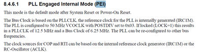

lama

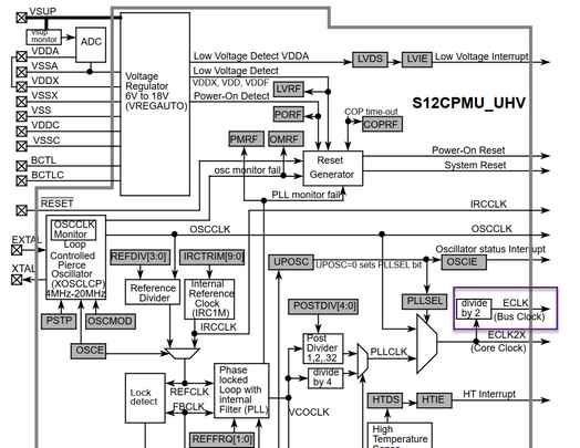

The MCU can be clocked for either internal or external oscilátor. The internal oscilátor is 1MHz in this devices family and i tis default configuration after reset. The default bus clock is 6.25MHz but you can change it by PLL setup.
PLL calculator.. https://community.nxp.com/t5/S12-MagniV-Microcontrollers/MagniV-PLL-Calculator/ta-p/1104351
Examples…
Chapter 8.7.3 Application Information for PLL and Oscillator Startup    in the reference manual

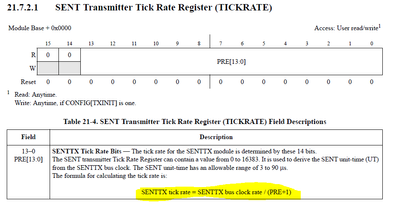

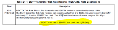

Our requirement is to set SENT tick rate to 3us (3 microseconds). Is my below understanding correct? If not please let us know how to calculate SENT TX tick rate.
SENT TX tick rate in frequency -> 1/3us-> 333,333.3333333333Hz
SENT TX bus clock = 32MHZ (FBUS)
Our assumption is SENT TX bus clock is nothing but bus clock (FBUS).
SENTTX tick rate = SENTTX bus clock rate / (PRE+1)
PRE+1 = SENT TX bus clock rate/SENT TX tick rate
           = 32MHZ/333,333.3333333333HZ
           = 96
PRE     = 96-1
PRE     = 95
If we set PRE to 95 then SENT TX tick rate is set to 3us correct?

lama
yes, you are right for given busclk and required tic time.

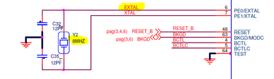

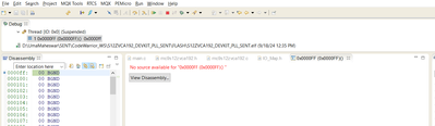

UmaMaheswaraReddy
Hi Ladislav,

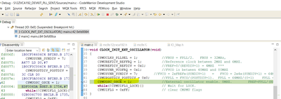

We are using S12ZVC-DEVKIT. As per the S12ZVC-DEVKIT schematic we are using external 8MZ oscillator.
Below is the NXP provided sample code. If we flash below code after enabling external oscillator software is entering unknown state. Could you please help us in this? We want to set FBUS 32MHZ clock using PLL.
UmaMaheswaraReddy_1-1726643234018.pngUmaMaheswaraReddy_1-1726643234018.pngUmaMaheswaraReddy_2-1726643253989.pngUmaMaheswaraReddy_2-1726643253989.png

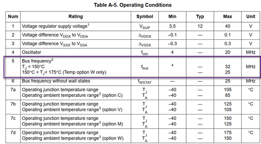

danielmartynek
Hi @UmaMaheswaraReddy,
The BUSCLK can be measured at ECLK (PT7).
If you use the values from the PLL calculator:
And check the registers after configuration, you should measure 32MHz BUS_CLK at ECLK.
Note that 32MHz is the max. allowed BUS_CLK freq at Tj < 150C.

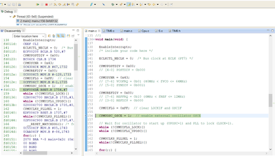

UmaMaheswaraReddy
Hi Daniel,
Same settings I used as per the PLL calculator.
Immediately after executing statement "CPMUOSC_OSCE = 1;" software entering unknown state.

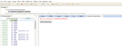

UmaMaheswaraReddy
Sorry for the delay in response.
I am using S12ZVC-DEVKIT. I selected micro as S12ZVCA192.
Same issue with the attached software also.

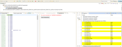

danielmartynek
What do you see in the registers of the S12ZMMCV1 module when this happens?
Are all the interrupt routines implemented in the project.
Refer to this interrupt catcher:
https://community.nxp.com/t5/S12-MagniV-Microcontrollers/S12Z-Interrupt-catcher-for-unexpected-inter...
Is there a machine exception rising?
