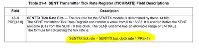

Our requirement is to set SENT tick rate to 3us (3 microseconds). Is my below understanding correct? If not please let us know how to calculate SENT TX tick rate.
SENT TX tick rate in frequency -> 1/3us-> 333,333.3333333333Hz
SENT TX bus clock = 32MHZ (FBUS)
Our assumption is SENT TX bus clock is nothing but bus clock (FBUS).
SENTTX tick rate = SENTTX bus clock rate / (PRE+1)
PRE+1 = SENT TX bus clock rate/SENT TX tick rate
           = 32MHZ/333,333.3333333333HZ
           = 96
PRE     = 96-1
PRE     = 95
If we set PRE to 95 then SENT TX tick rate is set to 3us correct?

lama
yes, you are right for given busclk and required tic time.
