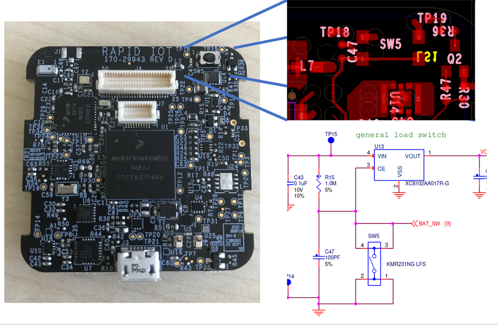

It turns on but there is no off?? Rapid IOT prototyping kit.

Yes there is a setting and looking into code there is API in the driver to adjsut backlight up or down or off.
I am not sure I am getting your question on the cables. I can interpret it in 2 ways:
Should you be willing to add your own wire, take a look below:
The idea is to pick the BAT SW signal referred above on SW5 (this is the switch also used for reset)
Soldering a wire on one of the 2 bottom pins and getting it out will allow you to connect a mechanical switch which you will be able to use to turn Rapid IoT completely off (no 3.3V is supplied anymore)
Should you be willing to connect to the white 50 pins connector to access BAT_SW signal:
https://www.mouser.fr/ProductDetail/Hirose-Connector/DF1240-50DP-05V86?qs=zOgoZG1CgI8VnrpeRnvNMg==
We do not supply cables as expected use case is that users make use of an Hexiwear docking station
But I added aboce a link to the connectors reference so you could build your own cable.

Eric_Ma
Actually only the display is turned off (Display and backlight)
The display itself consumes ballpark 100µA on top of my head so you could leave it on, but backlight is more like 10mA
The processors continue running in background.
You can have a general overview of power consumption here:
https://community.nxp.com/thread/491575
and turn what you do not need of in your project.
Remember the kit is a prototyping tool so for sure not perfect and matching all expected use cases.
This said you could tinker your own switch looking at Rapid IoT schematic.
The docking station on/off is connected to a switch which commands the regulators into Rapid IoT
So connecting to pin 24 at the back of the kit you could turn the kit off - This is the only way I foresee you could implement rapidly a on/off button,
