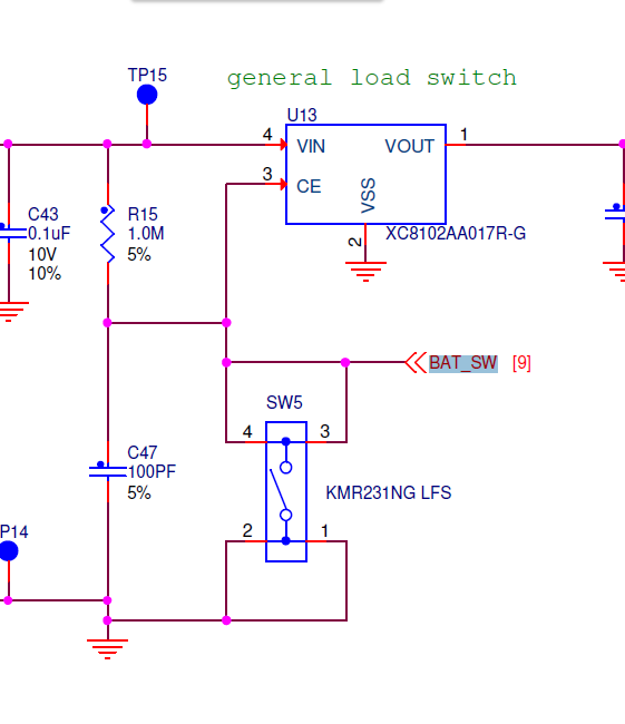

It turns on but there is no off?? Rapid IOT prototyping kit.
10 Replies
3,078 Views
frq05186
Hi Ralph,
Yes there is a setting and looking into code there is API in the driver to adjsut backlight up or down or off.
I am not sure I am getting your question on the cables. I can interpret it in 2 ways:
Should you be willing to add your own wire, take a look below:
The idea is to pick the BAT SW signal referred above on SW5 (this is the switch also used for reset)
Soldering a wire on one of the 2 bottom pins and getting it out will allow you to connect a mechanical switch which you will be able to use to turn Rapid IoT completely off (no 3.3V is supplied anymore)

This said you could tinker your own switch looking at Rapid IoT schematic.
The docking station on/off is connected to a switch which commands the regulators into Rapid IoT
So connecting to pin 24 at the back of the kit you could turn the kit off - This is the only way I foresee you could implement rapidly a on/off button,
