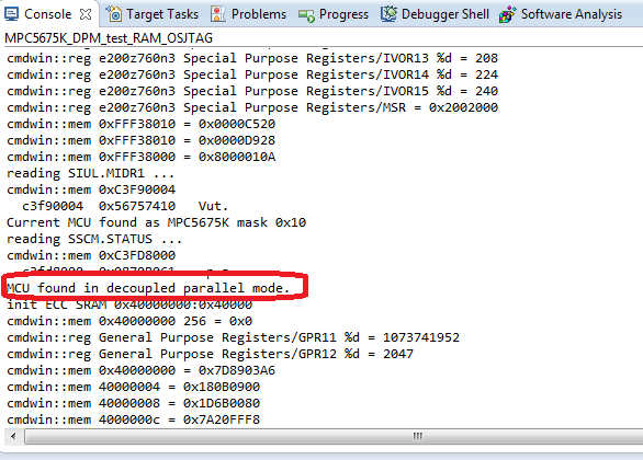

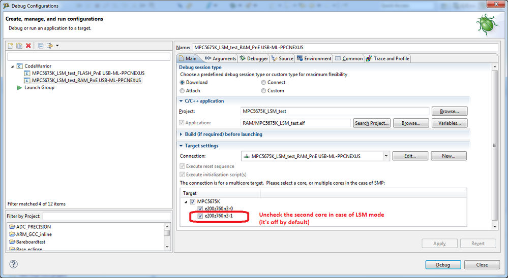

Have you erased/programmed the Shadow flash region? If you e.g. erased the shadow flash you might switch the MCU mode into LSM.
Therefore I'd first recommend you to make sure your bareboard project match with MCU mode (DPM or LSM).
In case both project and MCU are set to LSM mode and you accidentally enabled initialization of both cores (see attached screenshot) this error can occur as well.
FYI: the device mode is tested and printed into console view during TCL script execution. You will probably have to select the correct console since there are several different consoles running simultaneously.
