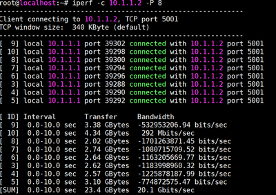

yipingwang
Please specify "-P 8", please refer to the following iperf result provided by the testing team.

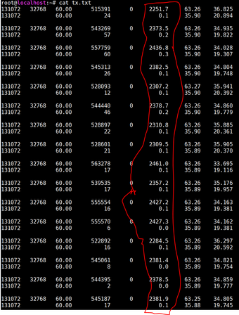

yipingwang
This is the result of netperf, the result is about 35.6Gbps.

Kassany
Thanks again @yipingwang, I have found a slight confusion of understanding about iperf3 and iperf2 frustrating the results.
Based on your tests with netperf and iperf2, the results are similar and expected.
