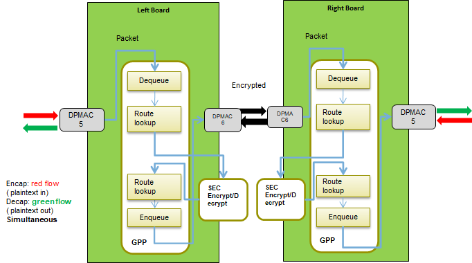

yipingwang
You could use DPDK.
Please refer to dpdk ipsecgw performance.
  LSDK20.12 kernel 5.4
name Framesize Throughput(Kpps) Throughput(Mbps)
dpdk_ipsecgw_caam_offload_50g_16c_perf 82 23,953 19,546
408 13,967 47,825
1,442 4,275 50,000

7,027件の閲覧回数
yipingwang
You could use DPDK.
408 13,967 47,825
1,442 4,275 50,000
