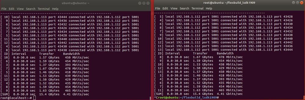

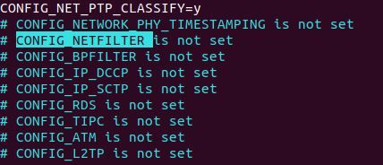

chhsu0229
Hi Yiping,
I followed your suggestion to recompile Linux Kernet with CONFIG_NETFILTER and CONFIG_CPU_FREQ disabled.
The speed result are
(1) LS1046 is Server and Linux Host is Client, and the average Bandwith is 3.83 Gbits/sec
(2) Linux Host is Server and LS1046 is Client, and the average Bandwith is 4.41 Gbits/sec
As a result, it does not work closed to 10 Gbits/sec.
