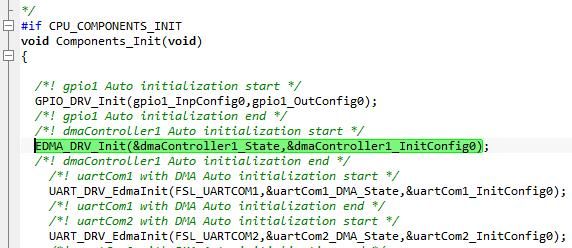

When I take out fsl_debug_console from Processor Expert the code when emulating gets stuck on DefaultISR, see below:
I had this problem earlier and I fixed it by adding back fsl_debug_console into Processor Expert. fsl_debug_console requires a UART resource and I do not have any to spare, so I would rather not use it.
The code seems to have a problem with the Processor Expert -Components_Init(); when there is no fsl_debug_console?

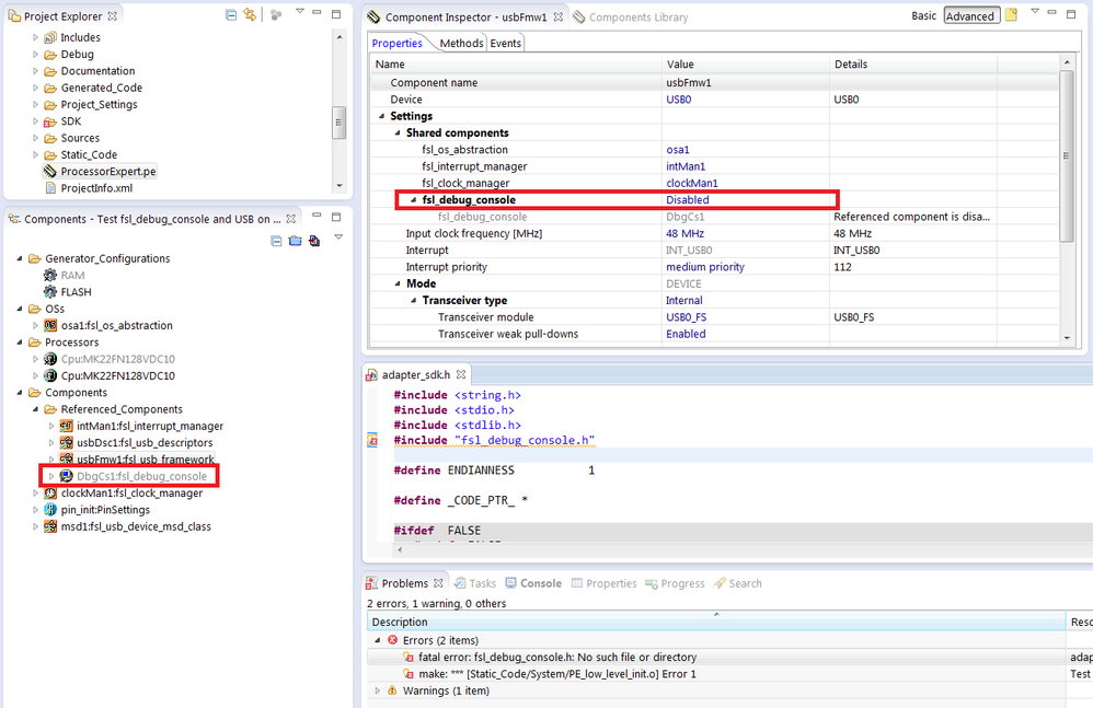

If you want to disable the fsl_debug_console in your project, you should disable the fsl_debug_console in the PEx project and also disable usage of slf_debug_console in the fsl_usb_framework in Settings/Shared Components/fsl_debug_console, see below:

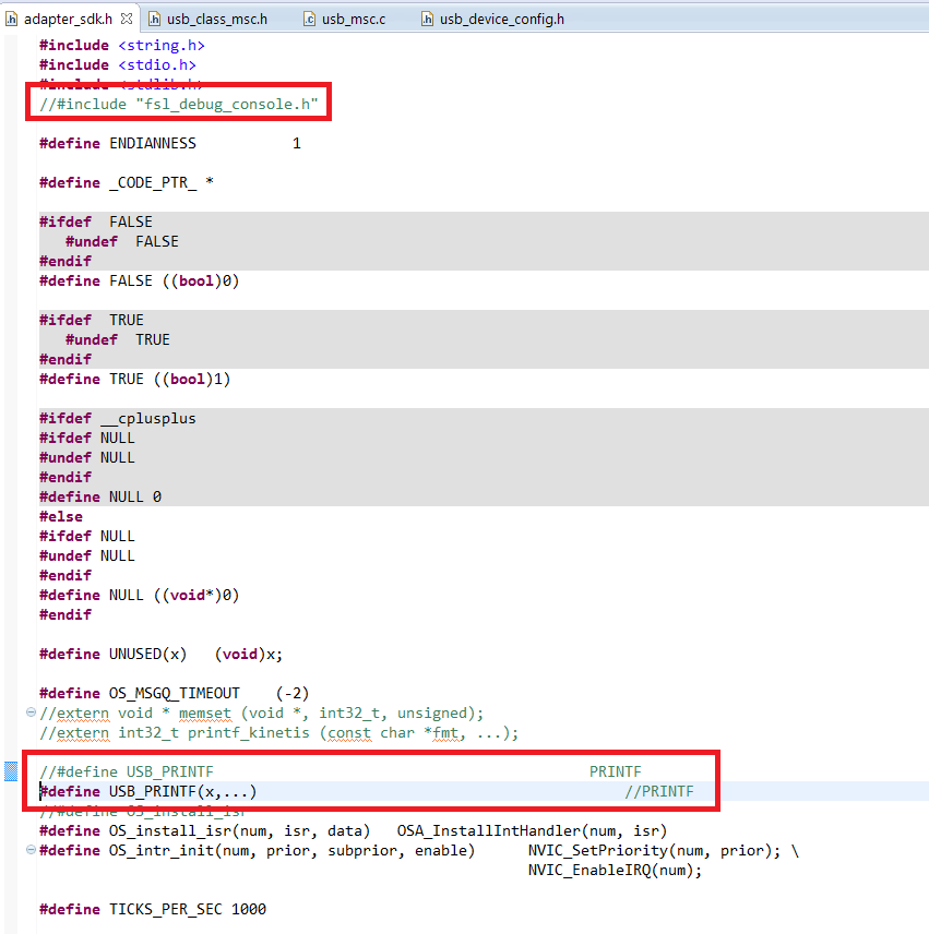

You must also modify the adapter_sdk.h static source code file (SDK\usb\adapter\sources\sdk\adapter_sdk.h). The fsl_debug_console.h include must be removed and USB_PRINTF definition changed. See below:
This modification remove all calls of the printf function from USB drivers.

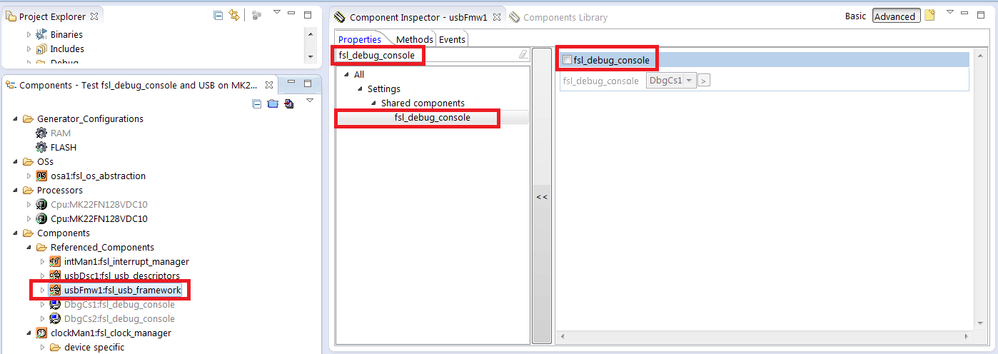

marek_neuzil
Hi Paul,
You can find the fsl_debug_console property in the Component Inspector of the fsl_usb_framework component. When you select the Tabs view (of Component Inspector), you can use the filter of properties. Write the fsl_debug_console in the filter column and select the fsl_debug_console property in the tree, see the screenshot below:
