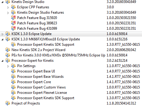

Hi Utsavi,
I have the same problem and was wondering if you solved your issue. I have the exact error you show in your screen shot with UTIL1. But I also have this issue with the CS1, TMOUT1, CLS1, WAIT1, and USB1:FLS_USB_Stack components. For me, everything was working until I added the USB1 component. Like Erich said, it relies on other components - CDC1, which relies on Tx1:RingBuffer, which relies on CS1. And CS1 has the same issue as UTIL1. But I don't know how to fix the lowest level components. They all reference KSDK1:KinetisSDK as you show in your screen shot. But I have that in Referenced Components and it has no errors. It seems like the other components can't find KSDK1.
My co-worker has a project set up in which these components all work perfectly. So we assume we have some difference in installation, paths, versions, etc, but after a couple of days of comparison, we haven't found anything.
I'm also using KDS 3.2.0. Here are screen shots of Installation Details and Components:
Roger Horton
5,802件の閲覧回数
BlackNight
Hi Roger,
from your screenshot I see you have created a project with the SDK enabled?
The Kinetis SDK does not support the Processor Expert FSL_USB component.
Create a project without SDK:
Then you can use the FSL_USB component.
I hope this helps,
Erich

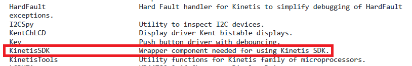

utsavikalpesh
Contributor V
Can anybody tell me how to register KinetisSDK template in Processor Expert??
Can I directly use KinetisSDK Component? By reading I come to know that KinetisSDK required Wrapper component..
What is wrapper component??
Why I am unable to use KinetisSDK Component?
Also by study I come to know that to register KinetisSDK, in .init file <Registration><template>...</template></Registration>  but I am unable to find .init file in KinetisSDK beans folder.
One more thing, Except the other components,  KinetisSDK is user modified component.User can modify it.(As per reading copyrights in .bean file).Is this creating problem of registration??
I am too much confused where to look to solve the error?
