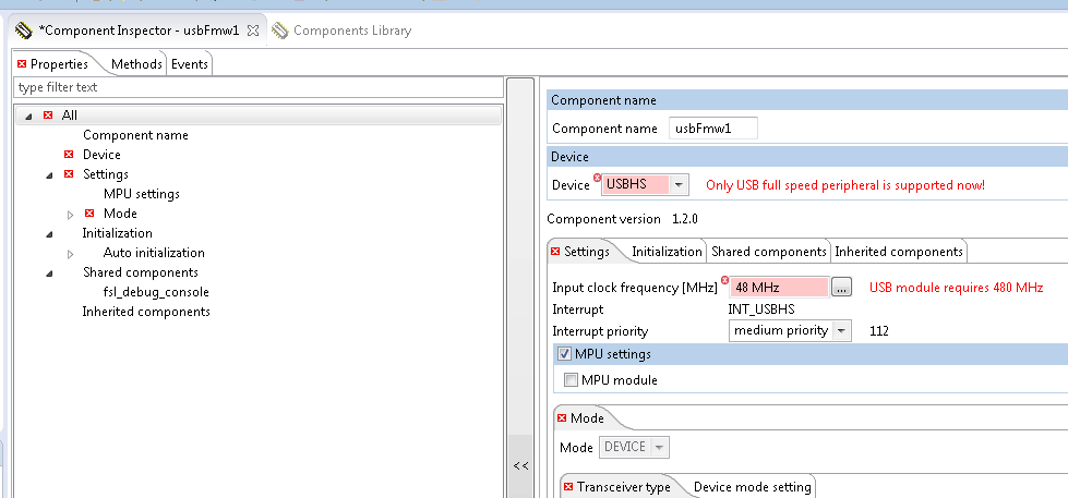

We are trying to use the USBHS for the K65 in Processor Expert.  When we add a component, it indicates that only USB full-speed is supported.  When will the high-speed support be added?
1,428 Views
marek_neuzil
The USBHS device should be supported in the next release of Kinetis SDK 1.3.0 (Processor Expert Kinetis SDK Support - Eclipse update package).
