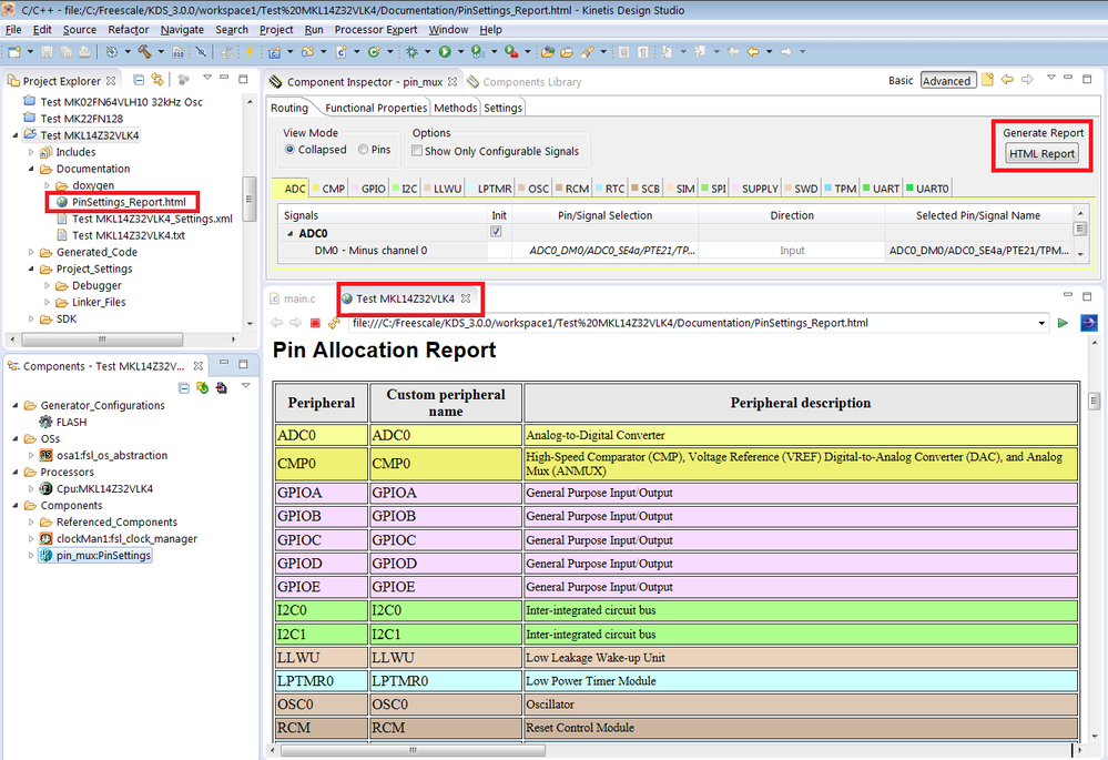

the doxygen output of Kinetis Design Studio/Processor Expert is a great feature. But for the controller I indend to use (MKL14Z32VLK4) the "Pins allocation" report can not be generated. It contains only the message "Pins model not supported for the selected target Processor".

The Pin Allocation Report is supported for the MKL14Z32VLK4 in KDS 3.0.0 + KSDK 1.2.0, i.e. when you create a Kinetis Project in KDS (MKL14Z32VLK4) and select KSDK 1.2.0 and Processor Expert the Pins Allocation Report can be generated, see the screenshot below:
Please note, that this project allows usage of Kinetis SDK components and Init components only (LDD components cannot be used when the KSDK is selected).

Please tell me the version of your KDS, and please screenshot the "Pin allocation " view on your side , and also the error message .

Here is a screenshot of the doxygen-generated html:
As expected, the rtf output has the same content.
