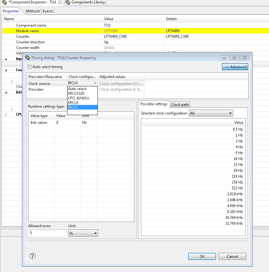

I have a question when I use the TimeUnit_LDD component in my KL25Z test project as:
(First I used LPTMR_CNR as a counter, I can choose different clock sources)

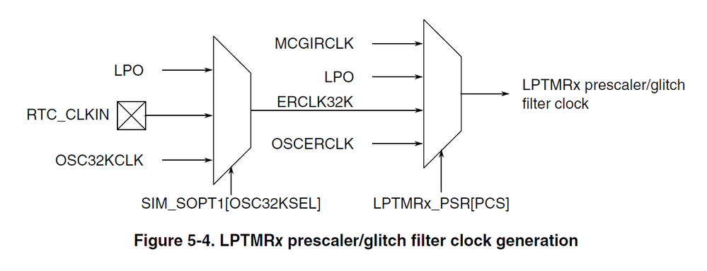

it can be explained as datasheet:

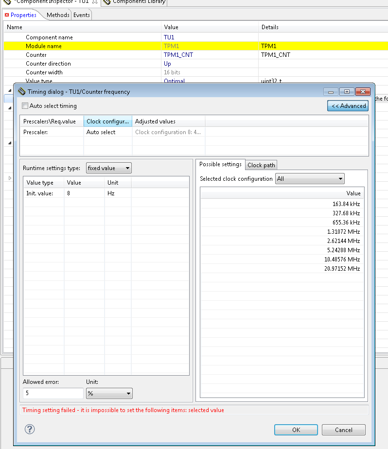

but when I try to use a TPM_CNT as a counter, there is no options in the Process Export Software for me to select the clock source as:clk_TPM1.png

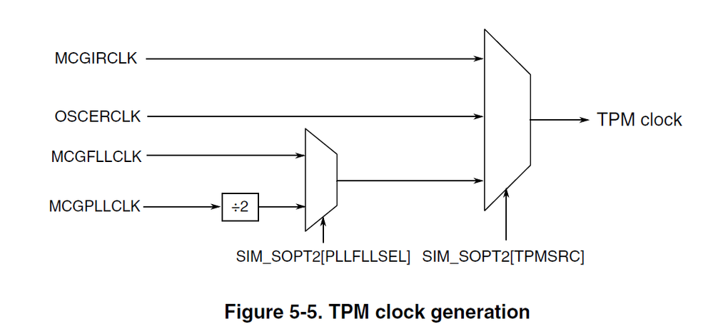

but the datasheet says there are three clock source options as:
Is there anything I missed or misunderstand?

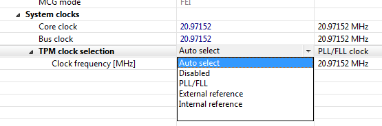

Hello henry xin:
The TPM clock source is configured as par of the system clocks in the CPU component:
Regards!

henryxin
Hi Gonzalez,
Thanks.
I missed the TPM part in the CPU component.
Henry Xin
