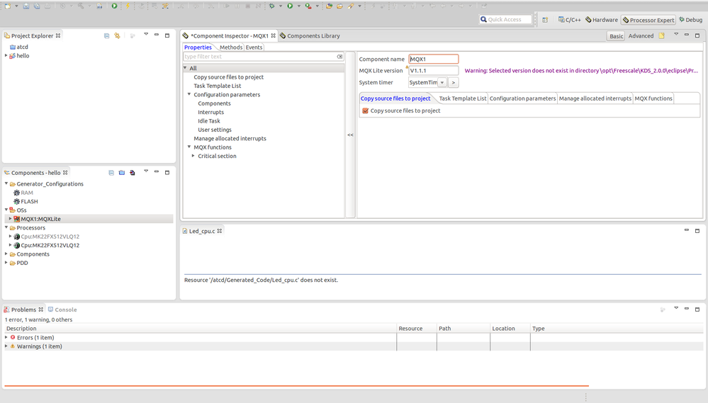

I'm running KDS in Ubuntu (tested on 14.04, 14.10 and 15.05).
When I run KDS without root permissions (without sudo), and I add MQXLite component, I get this message:
"Warning: Selected version does not exist in directory \opt\Freescale\KDS_2.0.0\eclipse\ProcessorExpert\lib\mqxlite\. (MQX Lite version)"
If I run KDS with sudo, no problems.
1,125 Views
marek_neuzil
This known issue of Processor Expert that has been fixed in the upcoming release (it will be available soon). In KDS 2.0.0 you can use workaround that is described in the discussion thread Error using MQXlite from Linux
