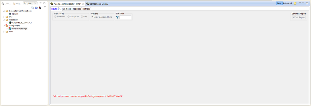

We are basing our next product on the Low-power L series processor with USB support. Specifically, the chip we are using is the MKL26Z256MC4. I am building the processor expert project and I want to use the Freescale PinSettings configuration to rename the pins and route them to the appropriate peripherals. However, when I try to instantiate the right component, it gives me an error message of which I have pasted a screenshoPinsettingsNotSupported.PNG.pngt.
To my knowledge, this is not a legacy part, so why is the PinSettings component not working?

Hello Alex,
I have find out that the MKL26Z256 derivatives support (Processor Expert with Kinetis SDK) is not published yet. These derivatives will be available in the Kinetis SDK 1.2.0 release (the release is planned at the end of April 2015).
Marek Neuzil
