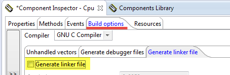

For my application I needed some extra RAM so via processor expert I disabled m_interrupts_ram.
It compiles and works so no problem there but now I always get the warning shown in the title.
Is there a way to suppress this ?

Hello Filip:
What part number are you using, is this a KL03?
I think that warning is harmless but if you want to avoid it then you have to disable linker file generation from the Cpu component settings:
Then change one line in the linker file:
From this ->     __VECTOR_RAM = ORIGIN(m_interrupts_ram);
To this ->          __VECTOR_RAM = __VECTOR_TABLE;
Then the warning should be gone.

Hi Jorge,
Thanks, that works perfectly.
The warning was probably quite harmless but it helps if there are not any so you notice if suddenly there are other ones.
