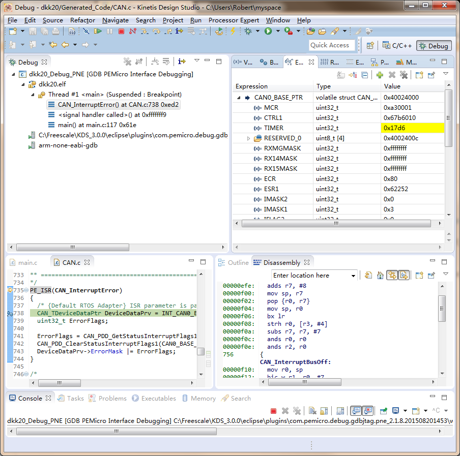

I have the problem to transmit message in program(see project in attached). In fact after to call the SendFrame(), I found that trig the PE_ISR(CAN_InterruptError). I have no idea to fix this problem. I think that should be the problem on setting, could you give me advise on it?

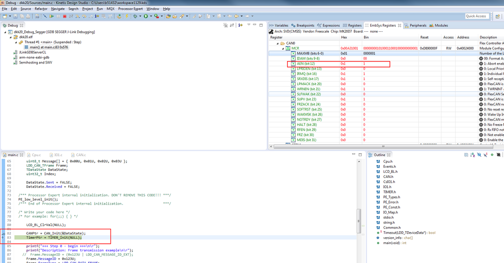

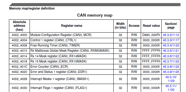

Another question is the CAN register: I found that the MCR is 0 before initial it, and change into 0xA30001 after initial, but I found it should be 0xD890000F after reset on reference manual as following picture, is it CAN component faille on the chip?

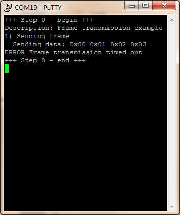

Here is the debug windows:
and terminal windows:

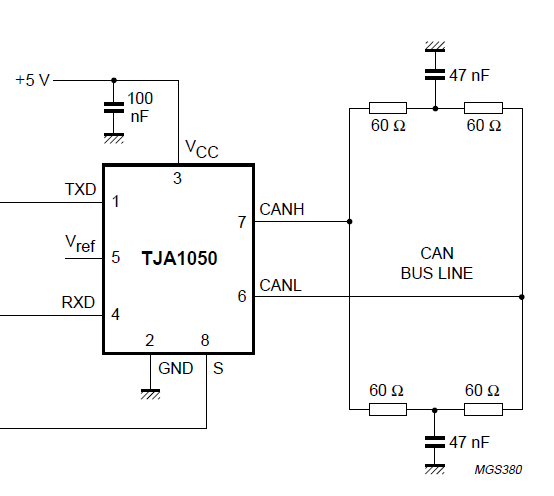

you can have problem with connection to a CAN bus. Have you connected the Rx and Tx pins to a CAN transceiver? For example using TJA1050 according to the following scheme:
If the Rx and Tx of the CAN device are not properly connected to a CAN bus (by using CAN transceiver) the CAN device will not send and receive any data.

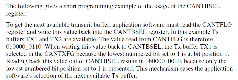

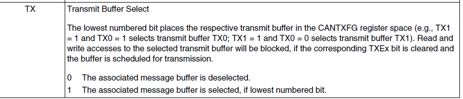

- About the MSCAN module ,  use the register of "MSCAN_CANTBSEL" select which buffer be used to transmit And how to select , i recommend you read this section (it in the MKE06RM):

Hello Zhong Shen,
(1) About the register of MCR, there is no error , in the Reference Manual ,
it meaning after reset, the MCR value is 0xD890000F, we can see in the screenshot :
the value of 0xA30001 is after the initialize function:    CANPtr = CAN_Init(&DataState);

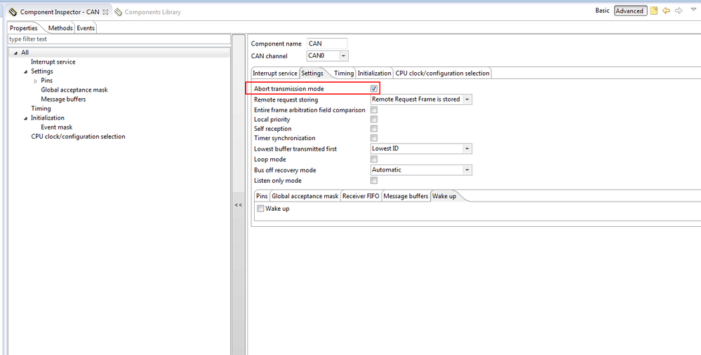

this function is generated after you configure the CAN_LDD component , this is reply to how
to configure it , for example for the AEN bit of MCR register :
- after you enable the "About transimission mode" :
  then generate code , then after run the initialize function , the bit of AEN will be "1"
(2) About your project , i will debug it  on my side to check the problem .

zhongshen
Hi Alice,
Thanks for you reply. It is help for me.
Agreed your opinion on MCR, actually I found the it is changed into reset value after executing  SIM_SCGC6 |= SIM_SCGC6_FLEXCAN0_MASK; in CAN_init().

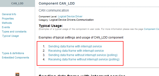

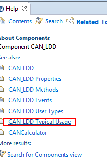

I recommend you refer to the demo of "Typical Usage: " , you can find them at here :
Hope it helps
