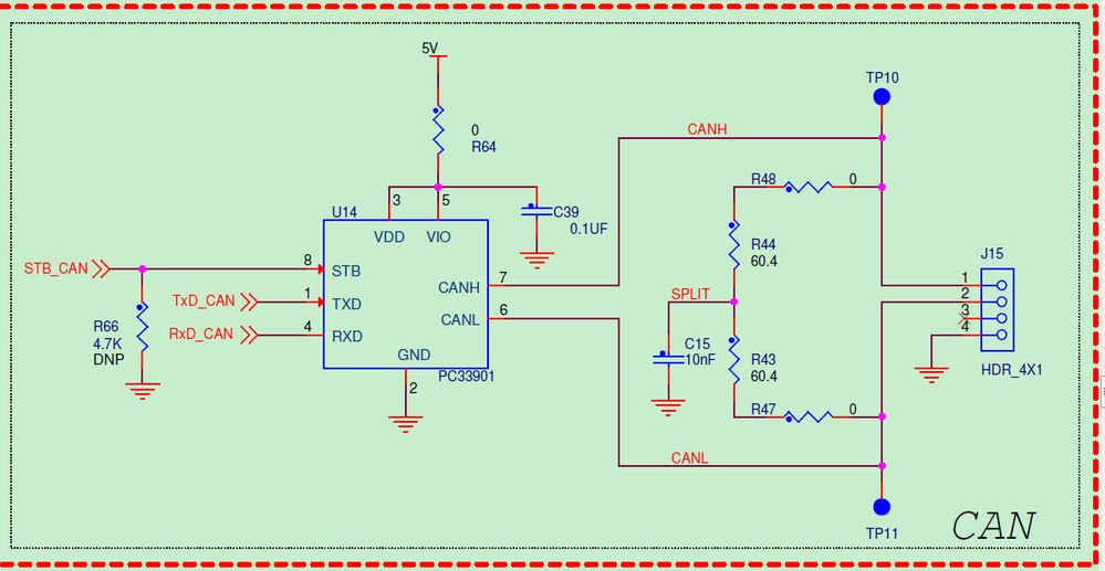

Though it works in loopback mode, I couldn't get it work when I connect the MSCAN (PTC6/PTC7) through a Freescale CAN tranceiver onto a CAN bus: neither CAN_OnFreeTxBuffer() nor CAN_OnFullRxBuffer( ) was called when periodically calling SendFrame( ). Then I did the second test with another CAN device sending data onto the CAN bus every 1 second, I still didn't get any interrupts while I could see the bus signal on MSCAN Rx pin. All settings are default except for the baud rate that was changed to 125Kb/s to match the speed of other CAN nodes on the same bus. I wonder why?

kerryzhou
Hi Chao Dong,
    Did you test it on our TRK-KEA128 board?
    I already test it on our TRK-KEA128 board, it  works ok on my side, and when I put break point in the CAN_OnFreeTxBuffer() or CAN_OnFullRxBuffer( ), these code can be entered, the according interrupt also can be entered.
    My test in connect the external CAN bus tool on the TRK-KEA128 board:
CANH and CANL.
If you have the TRK-KEA128 board, you can test it on your side.
If you still have question about the MSCAN, please let me know!
Jingjing

chaodong
Hi Jingjing,
Do you connect external CAN bus with your TRK-KEA128 board? I did that as a test but it failed to generate any Rx or Tx  interrupts. The external CAN bus was running ok while I did the test. Is there any other consideration in doing this test?
