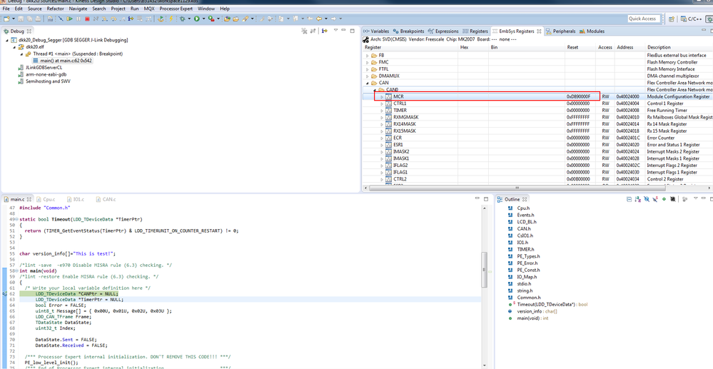

Another question is the CAN register: I found that the MCR is 0 before initial it, and change into 0xA30001 after initial, but I found it should be 0xD890000F after reset on reference manual as following picture, is it CAN component faille on the chip?
Here is the debug windows:
and terminal windows:

Hello Zhong Shen,
(1) About the register of MCR, there is no error , in the Reference Manual ,
it meaning after reset, the MCR value is 0xD890000F, we can see in the screenshot :
the value of 0xA30001 is after the initialize function:    CANPtr = CAN_Init(&DataState);
this function is generated after you configure the CAN_LDD component , this is reply to how
to configure it , for example for the AEN bit of MCR register :
- after you enable the "About transimission mode" :
  then generate code , then after run the initialize function , the bit of AEN will be "1"
(2) About your project , i will debug it  on my side to check the problem .

zhongshen
Hi Alice,
Thanks for you reply. It is help for me.
Agreed your opinion on MCR, actually I found the it is changed into reset value after executing  SIM_SCGC6 |= SIM_SCGC6_FLEXCAN0_MASK; in CAN_init().
Hope to get the you side result.
Zhong Shen
