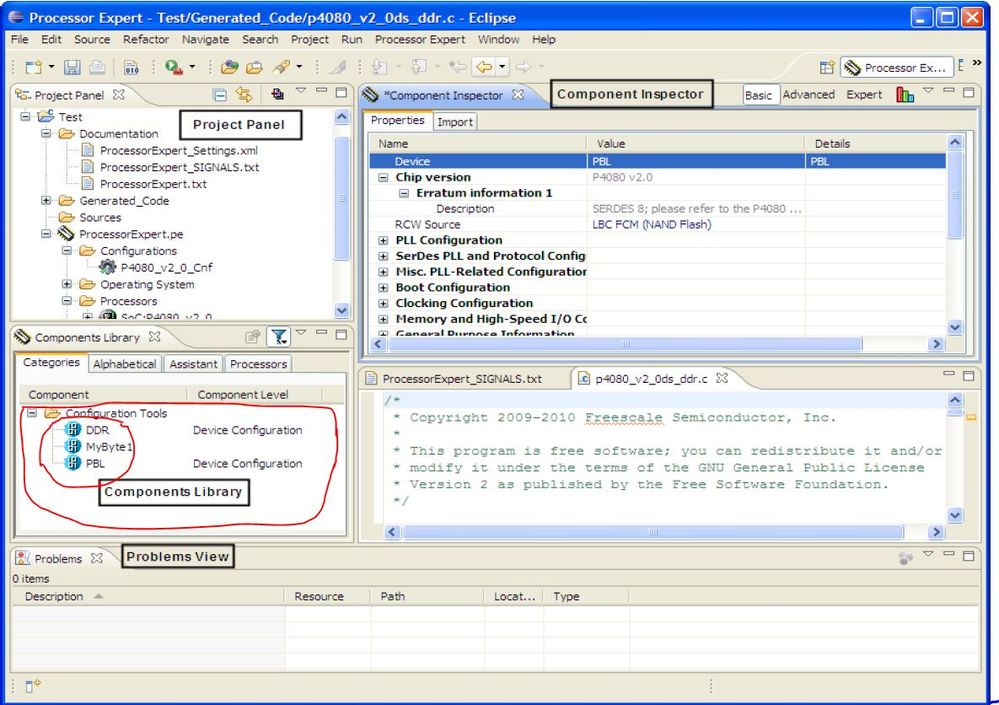

I have downloaded the QorIQ Configuration Suite plug-in to my CW PA 10.2.1  IDE and followed the instructions of a freescale video to create a QorIQ config. project but no empedded components appeared on the components library window so I coulnd't generate a Processor Expert code. Here is the image of my IDE4093_4093.JPGCapture.JPG
But the Components Library window should be look like this:
How can I get these components?
I have searched for days but I couldn't find out why it has no component or where can I find them.

The root cause of this issue has been identified. Processor Expert file decoding doesn't work well on machines with Turkish local settings - using Turkish character set.
A hot-fix solution is available.
The problem will be fixed in QCS 2.3.4 (22-May-13).
