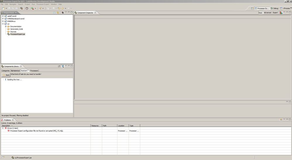

I have downloaded the QorIQ Configuration Suite plug-in to my CW PA 10.2.1  IDE and followed the instructions of a freescale video to create a QorIQ config. project but no empedded components appeared on the components library window so I coulnd't generate a Processor Expert code. Here is the image of my IDE4093_4093.JPGCapture.JPG
But the Components Library window should be look like this:
How can I get these components?
I have searched for days but I couldn't find out why it has no component or where can I find them.

The root cause of this issue has been identified. Processor Expert file decoding doesn't work well on machines with Turkish local settings - using Turkish character set.
A hot-fix solution is available.
The problem will be fixed in QCS 2.3.4 (22-May-13).

PetrKraus
this is a strange issue. QCS 2.3.3 has been tested on CodeWarrior for PA 10.2.1.
Please, could you send / attach to this thread the following three items?
- Content of the Eclipse (CodeWarrior) console
- .log file from the .metadata folder in your Eclipse workspace (both the file and the folder are hidden, you must allow hidden files and folders to be displayed)
- Zip archive with a content of <CodeWarrior disk location>\eclipse\ProcessorExpert\Config folder
Also, please check the path to the ProcessorExpert data is corretly set in CodeWarrior:
Window >> Preferences >> Processor Expert >> Processor Expert System >> Select PEx directory
You should see the  following path there:
Thank you.

PetrKraus
Thank you.
Please, try to create a new QorIQ Configuration Project and when the project creation process will finish, please, open the Eclipse console (it is in the same UI section as Problem Window at the Capture1.jpg screenshot you sent, the third tab), copy content of the console and, please, attach it too.

eminkoc
Thank you,
06.May.2013 16:16:55 Starting Processor Expert service
System directory = C:\Program Files (x86)\Freescale\CW PA v10.2.1\eclipse\ProcessorExpert
User working directory = C:\ProgramData\Processor Expert\CWMCU_PE5_00
Internal cache directory = C:\ProgramData\Processor Expert\PECache\27c556bb
06.May.2013 16:16:56 FAILED starting Processor Expert service
06.May.2013 16:58:43 Could not open project L/newqcsproject/ProcessorExpert.pe. Processor Expert service is not initiated yet.
