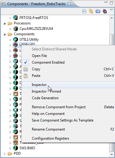

I created a new bareboard project, with PE enabled. PTA was initially configured with the TSI (I did nothing to cause this, it just came up that way). I needed to use some PTA pins for GPIOs, so I added the GPIO init component. This apparently worked and I was able to set the initialization parameters for PTA GPIOs. But the TSI was still there (for the other pins I presume) and so the icon inside the PTA box (on the chip graphic) displays a blue circle with some dots on it. The software knows there are multiple components for that port. Here's the problem. On all other ports, I can click on the box/graphic (on the chip graphic) and the component inspector will show the component. But for this one port where there are two components, it won't do that. No change. I have been searching menus for another way to select PTA but cannot find it.
So need a way to select a component in Component Inspector, other than clicking on the chip graphic.

I'm not sure if I can follow you, maybe you could post a picture?
Anyway, to open the inspector for a component, I typically use the 'Components' view. This one lists all the components in the project, and I can double click on the component to open the inspector for it.
Or I right click and then select 'Inspector'.
See screenshot.

there may be some pins used by signals for the processor components or the pin may be reserved for GND/VCC functionality. You can find icon also on the processor package for each pin (see Processor view). The name of the component shall be displayed in the tooltip for the pin.
TSI component is not included in the project by default. It might be useful if you specify name of the processor, used in your project. For example for MK60DX256, there are some PTA pins used for NMI and JTAG by default - see configuration in processor component - Internal peripherals.

Thanks Marek. The PTA pins are labelled as TSI, but in fact that 2nd component is the CPU, ie there are several pins on PTA that are used by the JTAG interface. The pin labelling on the graphic should indicate the usage of the pin.

Thanks Erich. That works.
