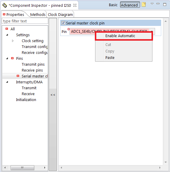

I get errors when I try to use the I2S master clock in the Init_I2S bean.  When I set the serial master clock pin I get this error :
DescriptionResourcePathLocationType
Direction Output cannot be set. Supported directions are: [Input/Output] (Pin)Main_K22I2S0/PinProcessor Expert Problem
I've tried changing that pin to the other available master clock pin and get the same error.  If I make it an input instead of an output I get a similar error that "Direction Input cannot be set."

Hi Josh,
I have send you the method to your email , have you receive it ?
The Processor Expert team engineer saids :
- In the component inspector of the Init_I2S component, open the context menu of the Pin property in the Serial Master clock pin group and select "Enable Automatic". The selection of the pin is cleared and an error is repoted (no pin selected).
- Open Component Inspector of the PinSettings, select Collapsed View Mode, I2S tab and select the required pin in the I2S0 > MCLK - Master clock property. The pin is selected and properly routed and the selected pin is also displayed in the Pin property in the Init_I2S component.
